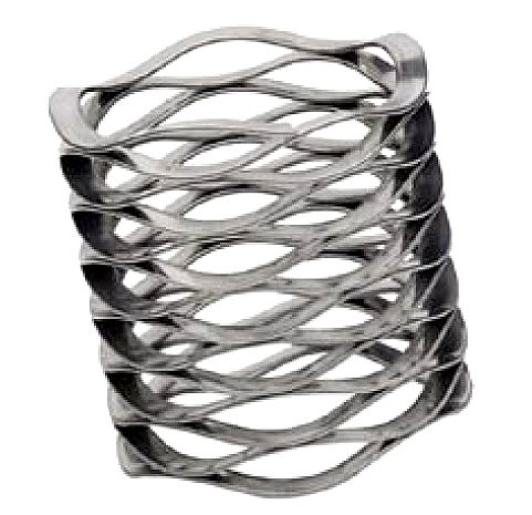

mattador04 Posted June 15, 2014 Share Posted June 15, 2014 How do you make a wave spring?? Let me guess: make points on a circle, array them, have two planes connect them with what, a spline? Then you have a path along which to sweep your profile, which is the cross section of the spring! I may have just answered my own question..... Quote Link to comment Share on other sites More sharing options...
Lazer Posted July 9, 2014 Share Posted July 9, 2014 That is one way much the same as this , another is import 3d points and spline then then sweep a profile. Quote Link to comment Share on other sites More sharing options...
Bishop Posted July 23, 2014 Share Posted July 23, 2014 When you say "wave spring" do you mean a Belleville spring? Looks like a washer with waves in it? Quote Link to comment Share on other sites More sharing options...
mattador04 Posted July 23, 2014 Author Share Posted July 23, 2014 Yes, a Belleville spring, I never knew that's what it was called.... Quote Link to comment Share on other sites More sharing options...
mattador04 Posted July 24, 2014 Author Share Posted July 24, 2014 Actually no, after doing a google image search, I realize that it is not a belleville spring I am talking about.... I'll model it (since I ended up figuring out the answer to my original question) and post. Thanks for the input! Quote Link to comment Share on other sites More sharing options...
Bishop Posted July 24, 2014 Share Posted July 24, 2014 Okay ... now I'm really curious to see what the actual part looks like, so make sure you come back with a picture, okay? Quote Link to comment Share on other sites More sharing options...
SLW210 Posted July 24, 2014 Share Posted July 24, 2014 Belleville washer (left) and wave spring (right) Quote Link to comment Share on other sites More sharing options...
mattador04 Posted July 24, 2014 Author Share Posted July 24, 2014 @ bishop: gimmie a few days n i'll do it.... busy as heck with machine work these days.... Quote Link to comment Share on other sites More sharing options...
mattador04 Posted July 24, 2014 Author Share Posted July 24, 2014 @ slw210 yes, those images are accurate Quote Link to comment Share on other sites More sharing options...
Faouweb Posted July 25, 2014 Share Posted July 25, 2014 Hi, I have tried to make what you asked, I hope it's correct You can Download the .IPT spring.ipt Quote Link to comment Share on other sites More sharing options...
