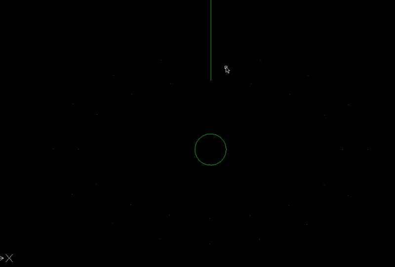

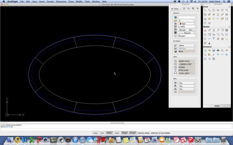

tails Posted June 13, 2014 Posted June 13, 2014 In the attached image there is an ellipse broken into segments. How do I work out the radius of each segment as when I split up the ellipse the radius tool does not work. Tracing over it with an arc is not accurate. Any ideas? Quote
JD Mather Posted June 13, 2014 Posted June 13, 2014 Tracing over it with an arc is not accurate. Doesn't the definition of Radius involve a (circular) arc? What are you going to do with this number that you are after? Are you familiar with the ellipse mathematical formula? Also, equidistant offset of an ellipse is not an ellipse. Quote
eldon Posted June 13, 2014 Posted June 13, 2014 I always thought that an ellipse has a constantly varying radius, which is given by the appropriate equation. I think there is no exact solution to your problem. Quote
tails Posted June 13, 2014 Author Posted June 13, 2014 Yeah, I understand that an ellipse does not have a radius. Basically its going to be a bar for a show I'm designing. It was going to be CNC'd but now they want it built in house. Each segment holds a particular food section. I need to provide some measurements to build it from and to be honest I'm stumped. Quote
eldon Posted June 13, 2014 Posted June 13, 2014 Perhaps you will have to make do with an arc which approximates the ellipse shape. Unless you can feed an equation into the CNC device. Quote
eldon Posted June 13, 2014 Posted June 13, 2014 Or plot it out to natural size and make a template. Quote
rkent Posted June 13, 2014 Posted June 13, 2014 Look up on the internet, ellipse with string, use that to dimension where the pins will go, they can draw it there in the shop. Quote

tails Posted June 16, 2014 Author Posted June 16, 2014 Hi guys, So I'm still working on this project. In the attached image are some nodes where I have divided the ellipse. The vertical line at the top "should" go through the 2 offset lines but it doesn't. Why would it not? I've drawn the ellipse once and offset it and another time using the same method as quick&easy describes. I can't figure out why it would not work. Quote
JD Mather Posted June 16, 2014 Posted June 16, 2014 Did you attach the correct image file? All I see is a circle and a vertical line? Quote
tails Posted June 16, 2014 Author Posted June 16, 2014 I've deleted the ellipse but left the nodes. I can see them but they are faint Quote
Quik&Easy Posted June 16, 2014 Posted June 16, 2014 When I zoomed in on the picture the nodes became clearer. If my sample helped you at all, give me the dimensions of your outer ellipse and the dimensions of your inner ellipse and I'll plot them out for you to work with. Quote
eldon Posted June 16, 2014 Posted June 16, 2014 I think that you should start at the beginning, and itemise each step that you are taking, and what you want the end result to be. Your first picture does not seem to give the same information as your second picture (can you alter the appearance of nodes in DraftSight), and I cannot see what offset lines the vertical line should be going through. Quote
rkent Posted June 16, 2014 Posted June 16, 2014 I approximated an ellipse using 4 arcs per quadrant. I divided the quadrant as shown so the arcs will follow the ellipse closely. Using the arc command start at the top, then move to the left using the nearest osnap to the approximate center of the first arc (12 o'clock to 10 o'clock), start the arc command and hit enter, pick the next endpoint, this will create an arc tangent to the first arc. Do that for the next two arcs. Pedit to combine them, etc. Now you can place dims for the arcs to locate center lines and, of course, the radii. ellipse with arcs.dwg Quote
tails Posted June 16, 2014 Author Posted June 16, 2014 Hi, okay so rkent's solution might work, I'll have a play later. The ellipse is 10000mm east to west and 6000mm north to south it's then offset 800mm to the inside of the first ellipse and broken into 16 segment. If I can follow rkent's instruction I can make an arc in 4 segments. Quote
