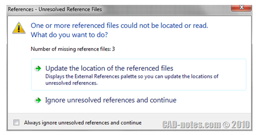

ReMark Posted June 11, 2014 Share Posted June 11, 2014 Is this the message you are seeing? Quote Link to comment Share on other sites More sharing options...
ajennings323 Posted June 11, 2014 Author Share Posted June 11, 2014 Yes, that is the message I am seeing! but the number of missing reference file is 1 Quote Link to comment Share on other sites More sharing options...
ReMark Posted June 11, 2014 Share Posted June 11, 2014 That was an example which means it wasn't meant to be specific to your problem. Basically the message means the file location on your computer is not the same as it is on the sender's computer. File location=path. Quote Link to comment Share on other sites More sharing options...

MSasu Posted June 11, 2014 Share Posted June 11, 2014 Yes, that is the message I am seeing! but the number of missing reference file is 1 That is probably due to the fact that you received 2 out of the 3 required x-ref's. Or two were attached with relative path, while one with absolute. ReMark however found 3 missing since you didn't uploaded here any of them. Quote Link to comment Share on other sites More sharing options...
ReMark Posted June 11, 2014 Share Posted June 11, 2014 MSasu: That message referencing three missing files was just an example. I did not open the OP's drawing. aj: Try changing the path to the file in the File Reference Manager where it says Saved path. Quote Link to comment Share on other sites More sharing options...

ReMark Posted June 11, 2014 Share Posted June 11, 2014 It has nothing to do with your knowledge of AutoCAD per se. It has everything to do with where AutoCAD expects to find the file (i.e. - the file's location). According to the drawing sent you the path to the file was probably on a server on the sender's end. The path to the file on your hard drive does not match that. You either change the path to the physically location on your server/hard drive OR you replicate the path of the original file. If it is a case that the sender did not include the missing file then that is a whole different story. Pick up the phone or email the sender and ask him/her to send you a copy of the DWG pronto. Quote Link to comment Share on other sites More sharing options...
