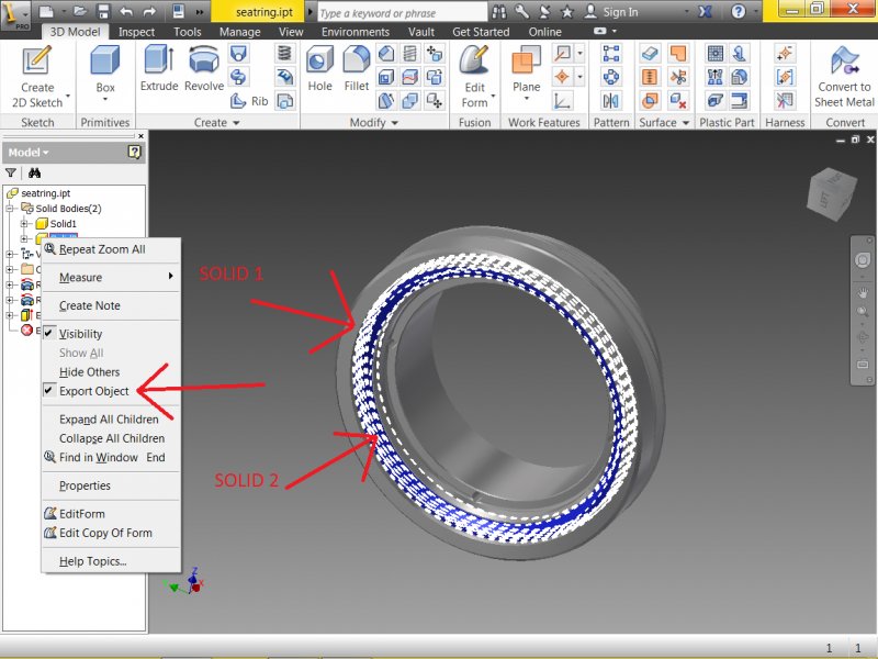

I have an .ipt file, which has two revolved profiles, each of which are separate solids. Can i push the second solid out as a new .ipt? When i rt. click on solid 2 in the browser, i get a check or uncheck option for "export object". What now? I've done something like this before, but it was a while back...... thanks ya'llinventor_screenshot.jpg
Manage tab>Make Part or Make Components (to push out both parts and create assembly).
Excellent. Thanks.
