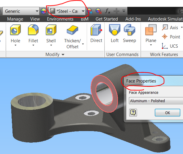

Vagulus Posted June 9, 2014 Posted June 9, 2014 That's it! How do I? I can't find it in Autodesk Help or in my textbooks. Google and YouTube were similarly unhelpful. Still, most models I see in books have finish representation. How is it done? Thanks Quote
JD Mather Posted June 9, 2014 Posted June 9, 2014 You can change part, feature or face Properties. Notice in the image I have the overall part set to a Steel-Cast texture. Notice that I have set the holes and machined faces to a shinier (I like the Aluminum Polished) texture. Simply right click on the face you want to change and select Properties. Quote
