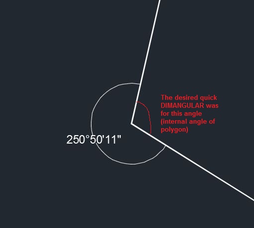

hey guys ,my 1st attempt in vanilla
It's just a quick whole-Circle dimension-Angular for line selection
Example: select 2 lines of 120° acute, you can get the rest 240° which >180°
(normal case command: _dimangular only get angle 60° which is
Its not the new topic but other threads show method
so just i share an alternative method for test.
;hanhphuc@cadtutor acad2007

  • 2 weeks later...
Multiple DimAngular on LWPolyline
;Works both closed & open LWPolyline
;can get 180° if vertex to vertex parallel;
;command: AngLWP
latest version v1.1 at post#13 - 11/12/14

  • 4 months later...
Hello hanhphuc,
The code works like a charm!! Thanks !!
It would still be of great help if by some change in the code, we can annotate complementary angles (e.g by this code if some angle is shown as 90 degrees, the complementary angle would be 360-90= 270 Degrees)
I think it is possible with the code as we just need to reverse the angle measurement, but I have no clue as to how it can be done..
Can you help?
Thanks in advance
Edited by torn_apart
Many thanks ,my friend hanhphuc ,
but ,I can't understand. can you make a demo ?
Hello hanhphuc,
Can you help?
Thanks in advance
hi torn_apart
welcome to the forum!
i not really understand, do you mean acute angle? but you can actually drag the to opposite side which >270
Hello hanhphuc,
Thanks for quick reply and warm welcome..
I get that, dragging it to the opposite side will give me the opposite angle.
But there are 100s of them...out of which the code is showing correct internal angles for 60...for the rest 40 this reversing would be needed...so I thought if we just reverse the angle measuring mechanism of the code and run it over the same set..then we would get correct angles for 40 and wrong for 60..
Then we can just merge the correct ones to get the whole thing.
Hello hanhphuc,
The code put the larger angle >180, so what you mean put acute angle as well?
Yes
Only smaller angles.
updated v1.1

im not good explain, dimension was created using activeX method vla-AddDim3PointAngular which refered to developer documentations.
same as manually command requires arguments (in red)
object.AddDimAngular (AngleVertex, FirstEndPoint, SecondEndPoint, TextPoint)
see inside the code :
(list cc (midp p1 cc) (midp cc p2) (polar m (angle m cc) (* (distance m cc) 1.25))) ;
AngleVertex = cc
FirstEndPoint = (midp p1 cc)
SecondEndPoint = (midp cc p2)
TextPoint = (polar m (angle m cc) (* (distance m cc) 1.25)) ;
;note: midp is the sub-function to obtain midpoint of 2 vertex
since you are new i just brief the method:
1.collect the coordinates of lwpolyline's vertex, check closed or not.
2.get the midpoint each leg for FirstEndPoint, SecondEndPoint
3.collect every 3 points AngleVertex , FirstEndPoint , SecondEndPoint respectively
4.using polar to obtain TextPoint
5.repeat the loop using foreach function
when you do manually almost same, the difference is just we need to automate determining every 3-vertex
HTH :)

; users can adjust global settings to suit their need here ,[color="red"] t / nil[/color]
[color="blue"]
(setq
*dimsuppressed* [color="red"][b]nil[/b] [/color] ; t= suppressed / [b][u]nil[/u]= normal [/b]
*dimtxtinside* [color="red"][b]t [/b][/color] ; [b][u]t[/u]= acute angle[/b] / nil= obtuse large > 180
)[/color]
(defun c:AngLWP	( / *error* pl lst p1 p2 cc m en l i v doc midp var sz box vobj )
