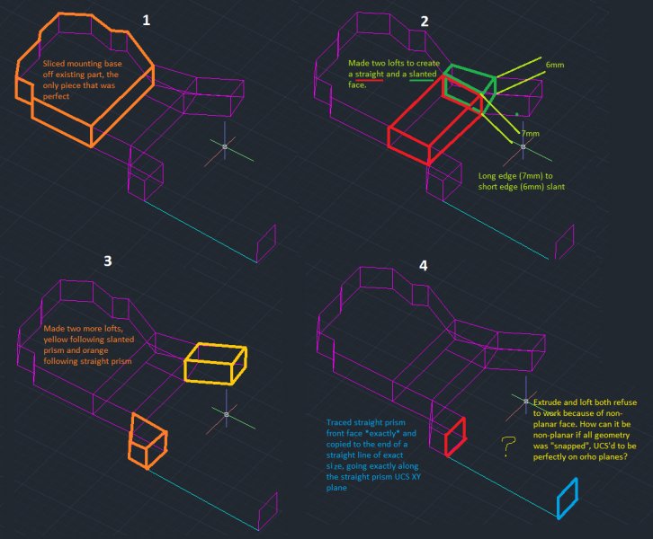

guitarpirate Posted June 15, 2014 Author Posted June 15, 2014 I've poured a lot of time and effort into making this part and restarted from scratch 3 more times, but unfortunately I got zero progress. I tried to model it additively, subtractively, with lofts, with surfaces, with meshes, with polylines, intersective booleans, nothing works. Hoping someone here can shed light on how to do this. Since I already spent 20 hours on it just this week I don't care if it's the "fastest" way, I just want "any" way. Last method I tried is additive booleans with polylines. Basically put the original geometry on a frozen layer, then built "perfect" polylines around it, making sure all sizes are exact and all polylines are coplanar for each face. When I got to the second pair of lofts, AutoCAD said my geometry was not co-planar. This means red face in diagram and blue face cannot be extruded, and lofting them creates a surface instead of perfect solid. I can't understand how that's possible because every time I created a loft face using 3d polyline, I chose just one vertical edge by tracing an existing vertical edge and copying it twice. After creating the top edge, I copied it to the end of vertical edge to create bottom edge. If that doesn't guarantee orghogonal edges, what does? Attached is DWG of isolated model in the process of being built and a diagram of how I got there. help.dwgFetching info... Quote
ReMark Posted June 16, 2014 Posted June 16, 2014 What is the object supposed to be? A quick look at your drawing reveals what appears to be a lot of extra (perhaps unneeded?) geometry. Could you explain what you were attempting to do? Quote

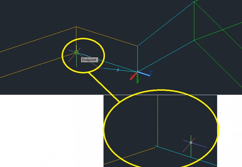

guitarpirate Posted June 16, 2014 Author Posted June 16, 2014 I am approximating Max Exoskeleton forearm from photo references. The bolt holes are 6mm and the length is what's in the drawing, the rest is open to interpretation. I am not trying to go screen-accurrate, rather a custom design that "looks better to me". So, I restarted from scratch once again and I see that AutoCAD is failing to snap my geometry properly. I set UCS to a flat plane that I want to constrain all my drawing to. Then I start drawing each line from the endpoint of previous line, and make sure it stays on the plane. In this case, I begin with one 3D object that all lines connect to, so I make sure the start points snap to 3D corners. Then I use the 2D rotate command to rotate the lines the way I want to after I create them with exact length. This further is supposed to make sure the lines are on the right planes. When I copy or connect them to each other, I always make sure to type "endpoint" in the command prompt, find the intersection/endpoint and wait until mouse-over tip says "endpoint" then plot the line... Then WHAM! They don't align: Can you explain how to handle this situation? Assuming I want the geometry to go very much the way it looks from my DWG files. The latest one even has all important dimensions rounded to .5 millimeter, because I submitted the drawings to CNC shop and settled on .5 mil as tolerance for manufacturing. The two slanted polylines that connect to green 3D object both don't even extrude let alone loft, for this precise reason (bad snap?) UA fold 1.dwgFetching info... Quote

guitarpirate Posted June 16, 2014 Author Posted June 16, 2014 Yes, I estimated using 2D paper on cardboard cutouts, with various pieces bent as needed. I printed everything 1:1, so the sizes in all drawings are designed to fit me. Some parts I change as I go from 2D from 3D, this one changed gribble detail and certain angles but of course remained the same length and roughly the same width. I think my question has more to do with why AutoCAD won't let me plot a bunch of simple lines the way I want to. There must be something I need to turn on or turn off to make this happen, because it's hard to believe that I would be sitting there 5 hours at a time and end up with 6 small solids and then it won't let me make 7th because something is wrong at a microscopic level. Quote

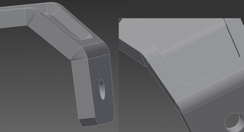

guitarpirate Posted July 20, 2014 Author Posted July 20, 2014 I switched to Inventor because some parts down the road cannot be easily done in AutoCAD, as a result I am re-doing this part in Inventor. I never did figure out how to do it in AutoCAD after sinking another month into it. Every single dimension is called out as promised, and all constraints are implemented. I also kept geometry as simple as possible with number of operations and did my best to organize the model tree. My question this time is: how do I make "sharp" bends instead of radius bends? I used the Bend feature to make 5.5mm radius bends, but I need the outside edge to be sharp. I tried to do the same by using rotated planes and extrusions to manually create the bends, but then couldn't figure out how to connect one extruded profile to another, because the arrangement of slopes on the sides of the bend was complicated and confusing. You can even see in this screenshot below that when using regular Bend feature Inventor creates some crazy geometry to make it happen: So how do I do the same thing, but with sharp bends, and presumably manually since there is no command to handle sharp bends? Quote
