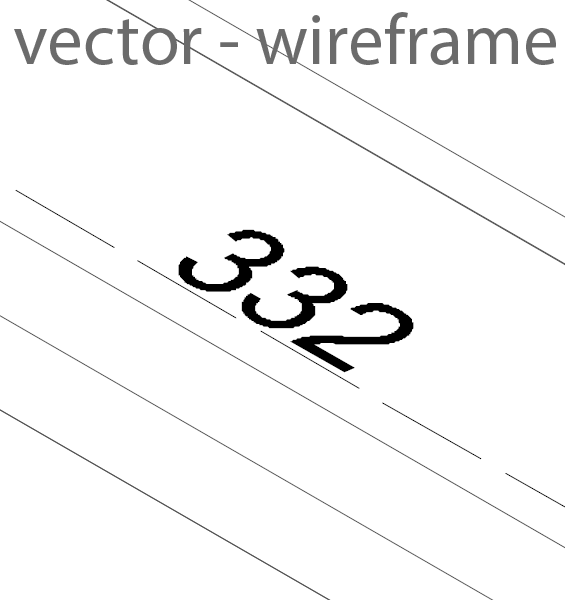

Hi, I'm new to AutoCAD, I've been using it for the past half year and have gathered enough knowledge to draw anything I need for my project, but I'm having problems plotting my drawings to .pdf (or printer or any other device).
When i plot with shade plot "Wireframe" the result is perfectly fine, the lines are clear, everything is easily readable. But when it use the shade plot "Hidden" or "Shaded" or any other than "Wireframe" i get a fuzzy image, that is hardly readable and difficult to hand out to someone.
It is the same no matter what setting i change. The image quality is poor already when i click "Preview", so it seems that it must be something within AutoCAD.
Here is an example of plotting my drawing, notice that the only difference in the settings is the "Shade plot" setting:
http://i.imgur.com/ztZ8mxF.jpg
Thank you for your help.

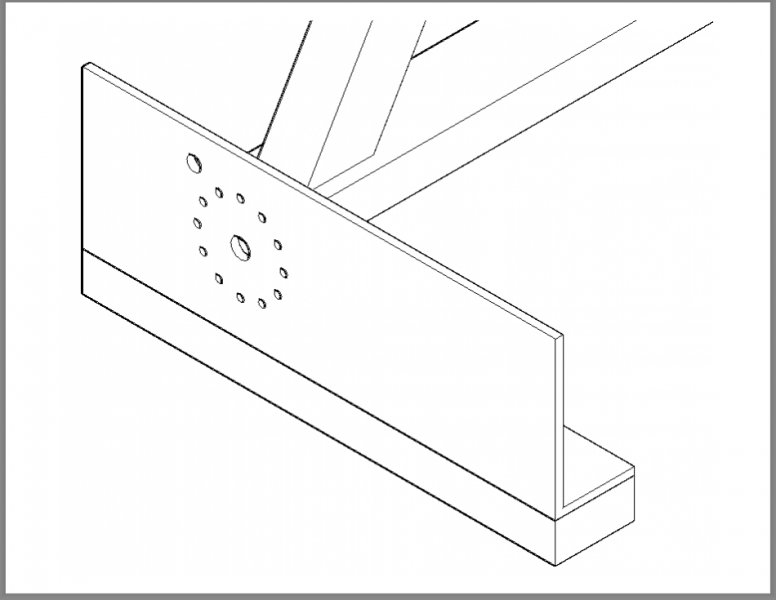

Screen shot of my plot preview using a monochrome.ctb, Legacy Hidden shaded plot option, with output to PDF via the default DWG To PDF.pc3 that comes standard with AutoCAD.
Would you not agree the preview is quite sharp?
Changing to a Hidden shade plot style (quality: maximum) the image does degrade slightly but nowhere near what your image displays.

I was merely trying to reproduce the problem you were seeing and to confirm what Tanner had suggested.

Thank you for your effort. Let me just explain that i fully understand what DPI is and how it works. My misconception was based solely on on the assumption, that everything in my "hidden" .pdf was drawn wrong, because i did not zoom in enough and Adobe Acrobat has a weird way to show some lines when zoomed out. My assumption that everything is wrong was triggered by the "unreadable" rendering of the annotations, which i still think is a problem, that i have to deal with.
See this example. When zooming to 800% in my .pdf i see now, that the lines are drawn OK (except for the compression artifact, which are gone when i use PDFCreate) so it's really not a DPI problem as I falsely assumed before.
But the number 332 (text) from the annotation is really rendered weird. It looks like its bolded or extruded to a level it's hardly readable.
So it looks like i have to find out why the annotations look like they look after converting.
