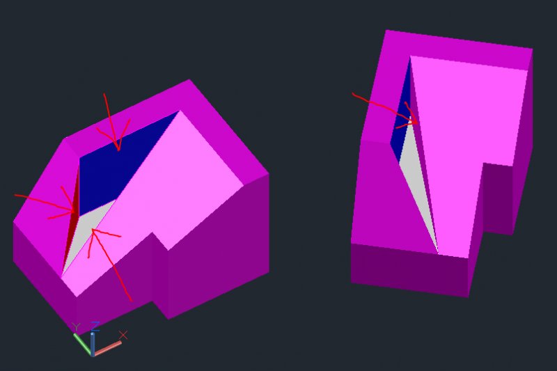

ReMark Posted May 30, 2014 Posted May 30, 2014 Sounds like you have a problem with your geometry. Did you check it? Was the assignment supposed to be done using surfaces? OK...I checked your drawing. If you use the SURFSCULPT command on the 3D model then take a closer look (use 3DOrbit) you'll see where you made your mistake. You introduce a void in the model that does not belong there. In other words, your geometry is wrong. Quote

ReMark Posted May 30, 2014 Posted May 30, 2014 The red arrows point to the four extra faces you created in your model. They do not belong there. Your geometry is wrong and will have to be corrected. Quote
pc30ty Posted May 30, 2014 Author Posted May 30, 2014 sorry dear ReMark , i did'nt see that ans,,tnx alot 4 ur foolow up; actually yes, our master said make an isometric and 3view plan of 2 objects! and if we want a 3d model for extra score! and somehow we were not been learned these at all! a actually made this 3d with a method I struggled for,in the cad tooolbars(first a whole box,then trim,then i used "taper faces" for atilt plans! 'coz of this poor method now i have those 4 faces! and actua;;y i don't know any other ways to correct them! Quote

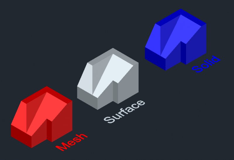

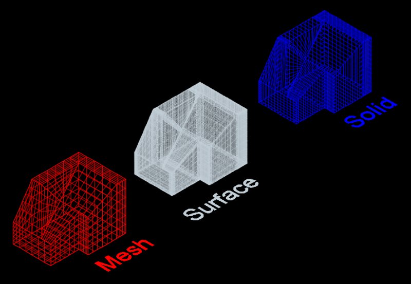

ReMark Posted May 30, 2014 Posted May 30, 2014 Outwardly all three look the same but they geometry is as labeled. Quote
ReMark Posted May 30, 2014 Posted May 30, 2014 Probably should have posted this first. Note the difference in the construction of each model. Quote

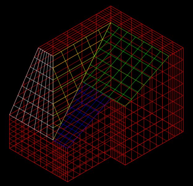

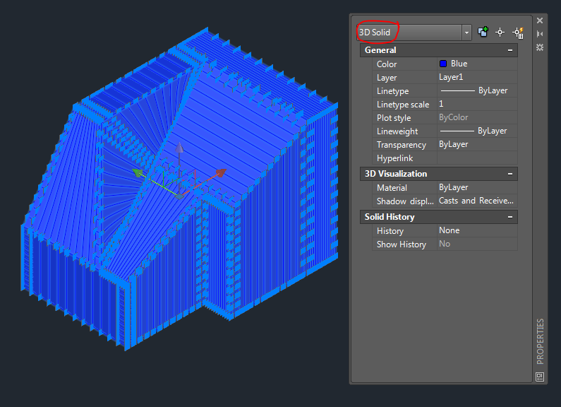

ReMark Posted May 30, 2014 Posted May 30, 2014 (edited) no problem dear, I 'm so grateful for Ur favor ReMark Show your gratitude by finishing the 3D solid model. Recreate the lofted surfaces but pay very close attention to the area your void was created in the last time around. If your lines are in the wrong place you won't get the right results. After you have created all your surfaces double check your model using the 3DORBIT command to orbit around the entire model while checking for the presence of a void or anything else that might look out of place. If everything looks good use the THICKEN command but specify a thickness no greater than 0.01. This will create separate solids in lieu of your separate surfaces. Now use the UNION command to join (union) all the separate solids into one solid. Done. Come on. I KNOW you can do it. I have faith in you. You have already taught yourself how to create surfaces so you are more than halfway there. Don't let me down. I am counting on you to complete this assignment. Edited June 11, 2014 by ReMark Quote
ReMark Posted May 30, 2014 Posted May 30, 2014 I have highlighted in different colors what I would say are the four critical surfaces to be created. Of the four the yellow one would be the most critical. I used the sloped vertical line in front and the top horizontal line to create that sloped triangular surface. Quote
ReMark Posted May 30, 2014 Posted May 30, 2014 Here is the sequence to one method that you might try. Surfaces - Separate Solids (Thicken) - Single Solid (Union) I doubt your teacher would think of it. Quote
