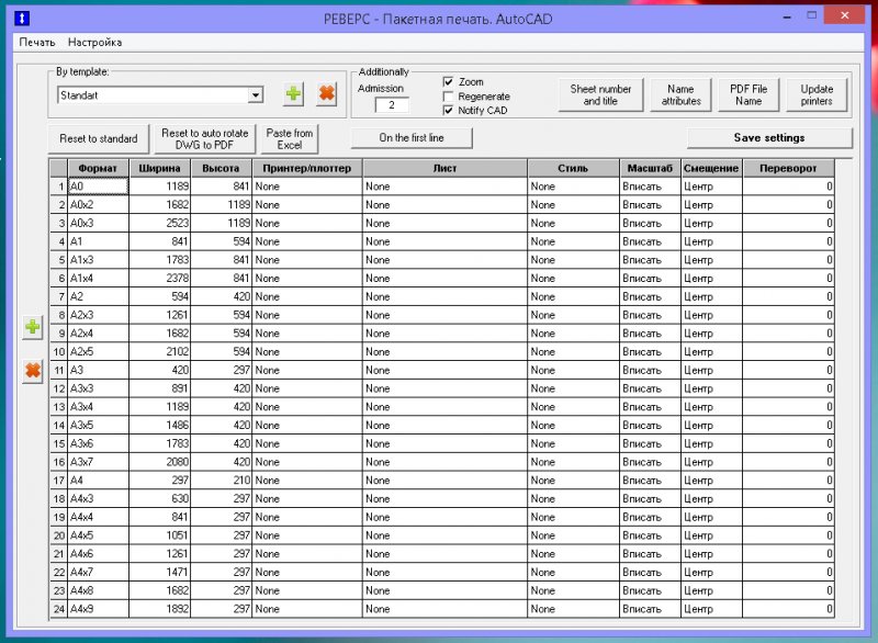

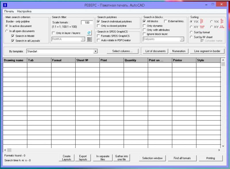

kArThIcK hAcKeR Posted May 30, 2014 Posted May 30, 2014 Hi, Guys i have 4 views in a drawing, (view the screen shot below) i have to plot these 4 views into a pdf document, (each view into a seperate page in the PDF ) now imagine me doing this for 40+ drawings files, in which each of the drawing file also has 4 or more views (this process is really frusturating ) I know about the layout setting method,(Setting up layouts for 40x4views is hard ) I tried a work around of plotting the full view of the 4 documents into A0 PDF, and then cropping and splitting the PDF pages, (This is also hard ) any ideas, methods or software recommendations are appreciated, Quote
maratovich Posted May 30, 2014 Posted May 30, 2014 (edited) Only help this program. It prints a batch of model space or layouts, where many drawings. Here is the link: https://www.kdmsoft.net/revers.html Here is a video tutorial: http://www.youtube.com/embed/eIH_u31JZrA Edited December 21, 2017 by maratovich Quote
kArThIcK hAcKeR Posted May 30, 2014 Author Posted May 30, 2014 Only help this program. It prints a batch of model space or layouts, where many drawings. Here is the link: http://www.kdm-info.narod.ru/revers.html Here is a video tutorial: http://www.youtube.com/embed/eIH_u31JZrA both the video and the site was in Russian(i think), and even google wasn't able to translate the page,,,.. but i'll try the software, if i could find the download button;) Quote
Organic Posted May 30, 2014 Posted May 30, 2014 both the video and the site was in Russian(i think), and even google wasn't able to translate the page,,,.. but i'll try the software, if i could find the download button;) http://www.kdm-info.narod.ru/revers/Revers_setup.zip looks like it Quote
kArThIcK hAcKeR Posted May 30, 2014 Author Posted May 30, 2014 http://www.kdm-info.narod.ru/revers/Revers_setup.zip looks like it thanks, ill try... Quote
maratovich Posted May 30, 2014 Posted May 30, 2014 (edited) Can be translated into any language. Write to the author of the program. support@kdmsoft.net Edited December 21, 2017 by maratovich Quote
