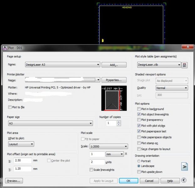

A bit more we set our layouts to metric A1 about 24x36 but we plot majority as a A3 its really easy. The layout has the title block true size 841x595 a scale of 1:1 we create mviews which are scaled within ppto fit the sheet. The A3 is just a case of changing in the PLOT the scale from 1 = 1 unit to 1 =2 units and selecting the A3 paper size.
