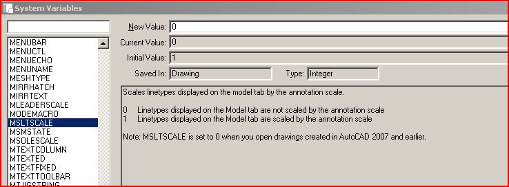

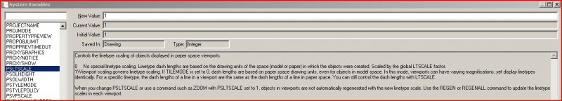

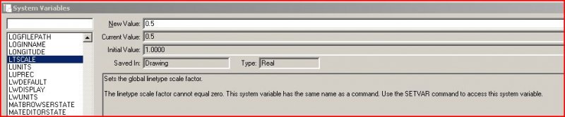

There are 3 variables which could be coming into play
LTSCALE which is your current global LT scale
PSLTSCALE which is specific to a particular Viewport (in Paper Space)
MSLTSCALE which is your Model Space LT scale

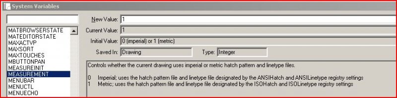

Or it could be that the MEASUREMENT setting is incorrect.
If you are working in Imperial it should be set to 0.
If you are working in Metric it should be set to 1.
Or perhaps the drawing units in the original drawing are different,
you could try the -dwgunits command to check that.

LTSCALE and MSLTSCALE and the Object LTSCALE (also known as the CELTSCALE System Variable) affect the visibility of objects in Modelspace. CELTSCALE stands for "Current Entity Linetype Scale" if I remember correctly. Here is my personal setup:
LTSCALE = 0.5 (
MSLTSCALE = 1
CELTSCALE = 1 (for all objects)
"CELTSCALE" is the same setting that is the "Linetype Scale" option in Properties when any object is selected. So selecting all objects will allow you to set all objects to a CELTSCALE of 1 (other than nested entities that are inaccessible, such as items in Blocks, etc). The only caveat is what the Annotation Scaling is set to in Modelspace. Set this to a scale size that will match the scale you'll be plotting to and then you'll have a consistent Linetype Scaling for all objects. The objects in the drawing you're copying from may have Linetype Scales overridden to each object (aka CELTSCALE).

As per BIGAL and droada's posts, those linetypes are controlled by the MEASUREMENT system variable setting, as detailed in the sysvdlg snip attached, which is why I suggested in my earlier post that you check that setting in the drawing which is giving you trouble.
First of all check the system variable MEASUREMENT in that drawing from the new source.
Then change it. It only has the values 0 or 1.
Then go into Linetype dialogue box, and click on "load", and pick all the same linetypes that are in the drawing. A message comes up to say that they are already loaded, but say Yes to reload all of them.
Then in the drawing, you should be able to reset the LTscale back to 1.

WE HAVE A WINNER!:
I set MEASUREMENT to 0. I reloaded all linetypes. REGEN, then changed LTSCALE back to 1, and MEASUREMENT back to 0. Problem solved.
