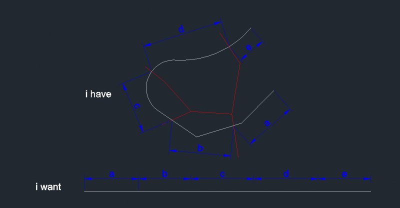

is there a way to draw lines connected to each other in one straight line. which would be drawn from the lengths of segments between intersection of polyline ?
i attached the situation.jpg to clear up the ... "situation".. :)
until now i was trying to use intlen.lsp to automatically show the lenghts of segments and then i would just dra lines one after each other with relative coordinates from the numbers i got from intlen.lsp...
thanks in advance..

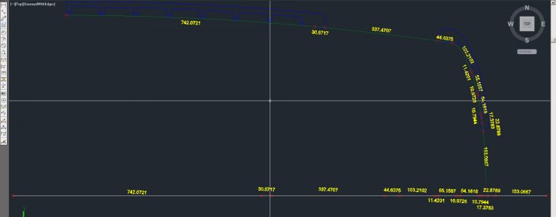

i need not the line which is the length of polyline but the lengths between intersections, only straightened to one line..
i attached another example.. but this time from the real project..
i have some parts.. which in this drawing are blue and the green polyline which intersects the blue parts in certain points marked in red..
with your length between intersections command i was able to see all the lengths (yellow) at once.. so i could just draw the lines one by one after each other by writing the lengths.. and the white line in the bottom part of the drawing is what i need.. but because i have about 300 different polylines like this and still have to have the ability to correct them later.. its too much time consuming..
so i thought its possible to make it automatically.. ..
i hope its clear.. thank you for your help..

thanks for the reply..
but as i see i find it hard to explain what i need..
maybe i should attach the dwg file?
i dont know how to write the code but the way i see it..
it should be possible to combine LeeMacs code for the length between intersections and the code he wrote in this thread..
another try for the explanation:
lets say i have an arc which is 15 in length.
it has an intersection with another object at point which divides the arc into two elements. 5 and 10 in lengths..
so the outcome of this situation should be the straight line of length 15 divided into two parts 5 and 10..
it can be one line with a node at the right coordinates,
or two lines drawn one after another with a lengths of 5 and 10..
i just need to be able to snap at that point on straight line..

Try the following code:

thank you..
it works perfectly...
