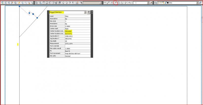

Dadgad Posted March 30, 2015 Posted March 30, 2015 Dana W said: I have a layout that was driving me absolutely monkey snot crazy for a few minutes, about a month ago. Whenever I ZE'ed it, the dang thing would actually get really tiny, about 1/100th of the screen, way down in the right hand corner. Well, it was the first time I had had to put a very large radius dimension in paperspace. I haven't been using paperspace dimensioning until recently, and I have found a lot NOT to like about doing them. Anyway, what was causing the weird zoom was the center mark of that large radius, about 9 feet outside the paper. Of course, I did the normal solution and selected all to find the boogie, but when I deselected everything inside the paper edge, the #$%^ grip would disappear. When I left to right selected for the grip nothing would light up. when I right to left selected in the area where the offending grip appeared, my radius dimension lit up too. Since I could not see what it was at that display scale, it took a couple more minutes before it finally dawned on me. Dana, I hope that your new gig is a good fit for you! The next time you have such a problem, just use a DIMJOGGED Radial dimension, and then when you zoom extents, the actual center of a large arc or circle will be ignored by the Zoom command, like in my screenshot. Quote
