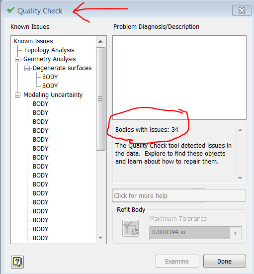

The SolidWorks user needs training - found a lot of errors and the part was not modeled with obvious symmetry about the origin (SolidWorks 101).

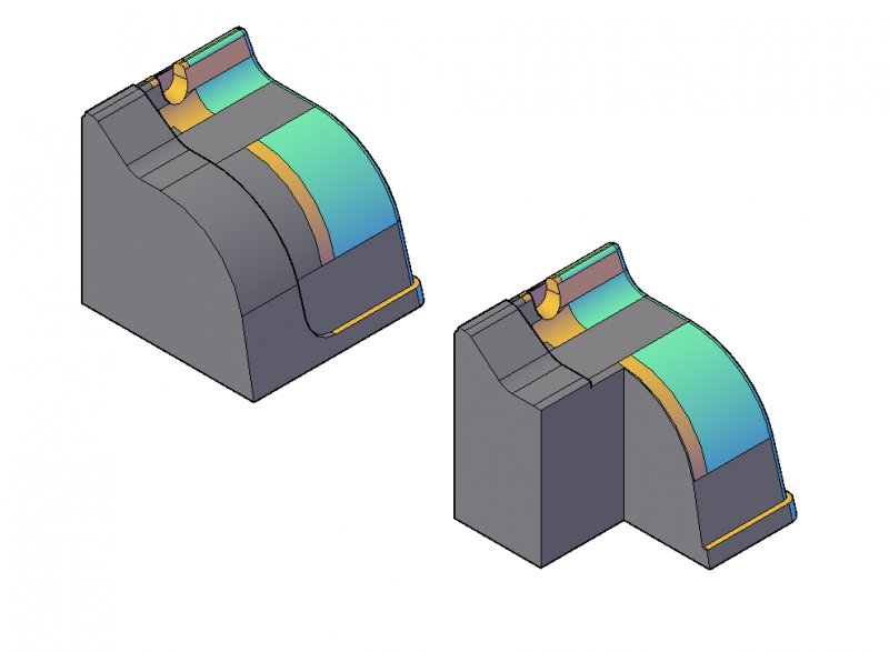

I think I may have done it...well almost. Just half of the 3D model. It was an interesting exercise despite the errors JDM found.
One half the model; then I sliced out a chunk just to make sure it was solid throughout.
ReMark, how did you do it?

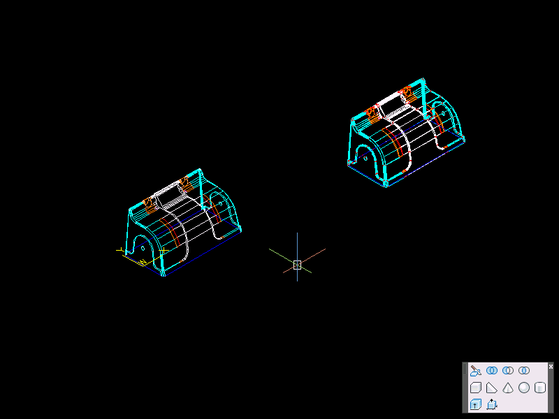

I encompassed the TP holder in a cube, sliced through the two objects with a surface, eliminated the front halves of both, subtracted what remained of the TP holder from what remained of the cube then separated the two of them from each other. Or I used magic. Can't remember which it was now.
Edited by ReMark
correction
Cool, I was hoping it was magic. Thanks for the input ReMark.

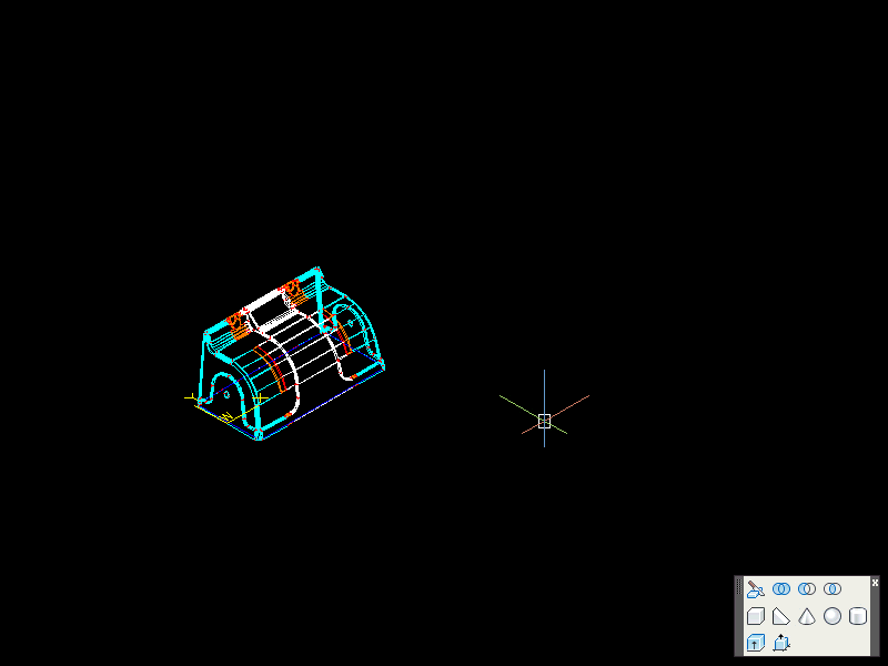

Another way.
I've divided the gif because of the size.
