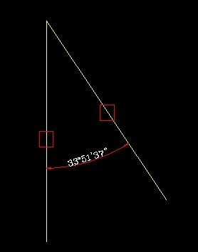

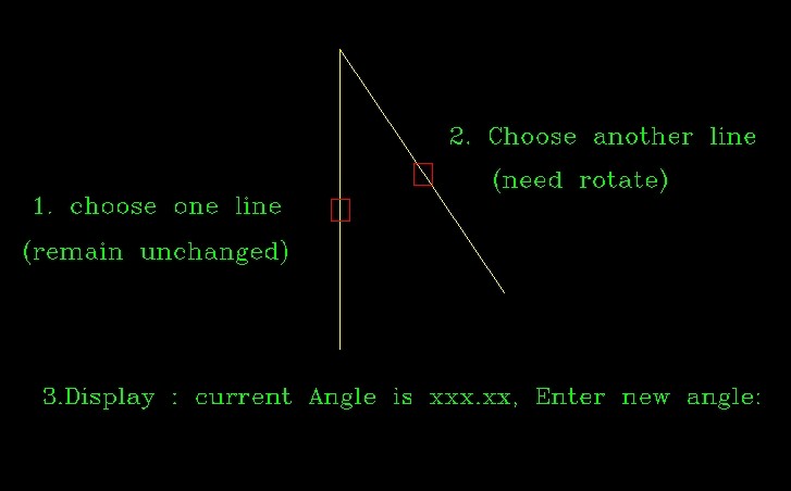

liuhaixin88 Posted May 26, 2014 Share Posted May 26, 2014 Change the Angle between two lines Quote Link to comment Share on other sites More sharing options...
Lee Mac Posted May 26, 2014 Share Posted May 26, 2014 Rotate > reference Given your other recent thread, I would suggest learning how to use your CAD software before requesting custom programs for tasks which can already easily be accomplished with standard commands. Quote Link to comment Share on other sites More sharing options...
liuhaixin88 Posted May 26, 2014 Author Share Posted May 26, 2014 Rotate > reference Given your other recent thread, I would suggest learning how to use your CAD software before requesting custom programs for tasks which can already easily be accomplished with standard commands. When the Angle is not an integer ,How to specify the reference Angle ? Quote Link to comment Share on other sites More sharing options...
Lee Mac Posted May 26, 2014 Share Posted May 26, 2014 When the Angle is not an integer ,How to specify the reference Angle ? You can pick the reference angle from the drawing. Quote Link to comment Share on other sites More sharing options...
liuhaixin88 Posted May 26, 2014 Author Share Posted May 26, 2014 (edited) You can pick the reference angle from the drawing. When specify the reference Angle , only pick two point, can't pick the Angle value Edited May 27, 2014 by liuhaixin88 Quote Link to comment Share on other sites More sharing options...
