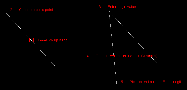

liuhaixin88 Posted May 26, 2014 Share Posted May 26, 2014 Like this image 1.Pick up a line or pline 2.Choose basic point 3.Enter angle value( less than 180 degrees ) 4.Choose which side ( Mouse Gestures) 5.Pick up end point or enter length. Thanks for any help! Quote Link to comment Share on other sites More sharing options...
Tharwat Posted May 26, 2014 Share Posted May 26, 2014 Use rotate command and after that use lengthen command . 1 Quote Link to comment Share on other sites More sharing options...
ReMark Posted May 26, 2014 Share Posted May 26, 2014 Or just enter the length and angle at the command line. Why does every task have to be done using a lisp routine? Maybe AutoDesk can develop a new CAD program with tons of commands that can ONLY be used via a lisp routine. Wouldn't that be just terrific? Quote Link to comment Share on other sites More sharing options...
liuhaixin88 Posted May 26, 2014 Author Share Posted May 26, 2014 Use rotate command and after that use lengthen command . Oh! I I almost forgot command "rotate" , Thanks. Quote Link to comment Share on other sites More sharing options...
Tharwat Posted May 26, 2014 Share Posted May 26, 2014 Oh! I I almost forgot command "rotate" , Thanks. Rotate with copy option and that 's what I meant . Quote Link to comment Share on other sites More sharing options...
