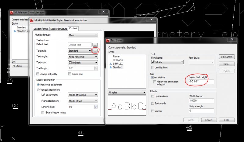

I created a new multileader - Standard - annotative
In layer style mgr I am not able to change the text height. It is grayed out 1/8. I need 1/16.
Aside from that issue, I have a problem with the arrow.

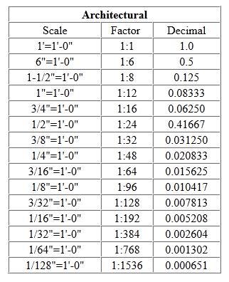

Isn't 1:200 considered a metric scale?
I respectfully disagree that 1:200 is the same as 1"=200'.
ISO standard metric scales: - 10:1, 5:1, 2:1, 1:1, 1:2, 1:5, 1:10, 1:20, 1:50, 1:100, 1:200. 1:500, 1:1000, 1:2000, 1:5000...
Typical imperial scales for site plans.

Did you happen to verify what this 1:200 scale is set to in the scalelist?
Typical architectural scales as used in the U.S.
Most plan views of a building are done either in 1/8th or 1/4 scale.
Details will be done at a larger scale. Ex. - 1/2'=1'-0" or 1 1/2"=1'-0"
Site plans are done using engineering scales such as 1"=20', 1"=40', 1"=50', 1"=100', and 1"=200'.
USGS quad maps are done at a scale of 1"=2000'.

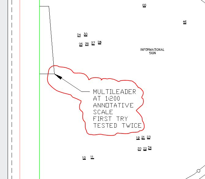

Strange. I just clicked on multileader, drew my leader, added my text and it showed right up, arrowhead and all.
I just checked. It's 1:200.
Recognize this? I did it twice just to make sure I was doing what you asked. Worked both times.
