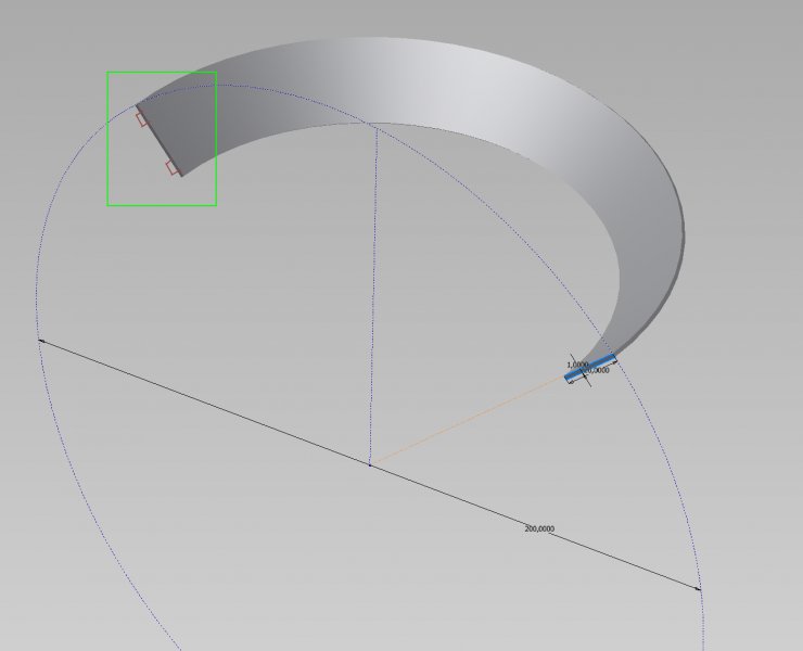

is there any way to create part like in attached file and add tabs on each side so part can be correctly unfolded ? need dxf shape.
there are two thickness 2, 3 which are very important. i think they are complicate a little since we can build sketch on sides.
thanks

Sketch1 is not fully defined.
What is the angle?

there will be a lot of parts one above another. it is just an example
attached is surface work. now work on solids. hundreds of parts.

You do not need to draw a rectangle to get a Contour Roll (conic sheet metal) all you need is a single line.
Guest kruuger
ah yes, that's good. easier and faster. thanks
