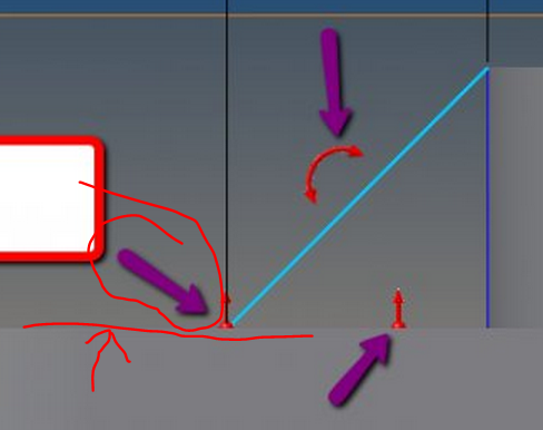

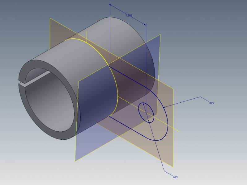

I was trying to draw the 2 ear pieces with concentric holes sticking out on the round surface. but i am not sure if this is the right way to go, if not any other way? i was using the tangent to surface through edge. i sketched on the horizontal plane but the end of two lines didn't project to touch the surface of the cylinder (Note: see two red arrows). Which plane should i sketch on Vertical or Horizontal? please advice

I was about to extend the two sides of the tongue to meet the cylinder when I ran into trouble. Inventor tells me the sides have a dimension and won't allow me to extend them.
Would someone please tell me why? Thanks

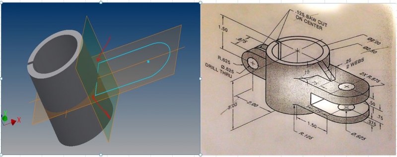

In the real world how would that part be made?
All of the white faces are machined faces.
You are trying to violate real world logic.

Did you work through the way JD did this exercise? He simply extruded the tongue right inside the parent block and let the blending take care of itself.
Run his IPT up and work through his modelling sketch by sketch.

In Sketch 3 use the Project Cut Edge command. This will project the outer diameter onto the Sketch/Workplane. Get rid of that tangent vertical line. Trim the tab edge lines to the diameter. Properly constrain the rest of the geometry. Then Extrude and Cut away as needed.
Eschclark, how did you get the plane to tangent to the edge of the cylinder? I clicked the tool plane--tangent to surface through edge or through point but i after i select the edge of the geometry nothing happen.

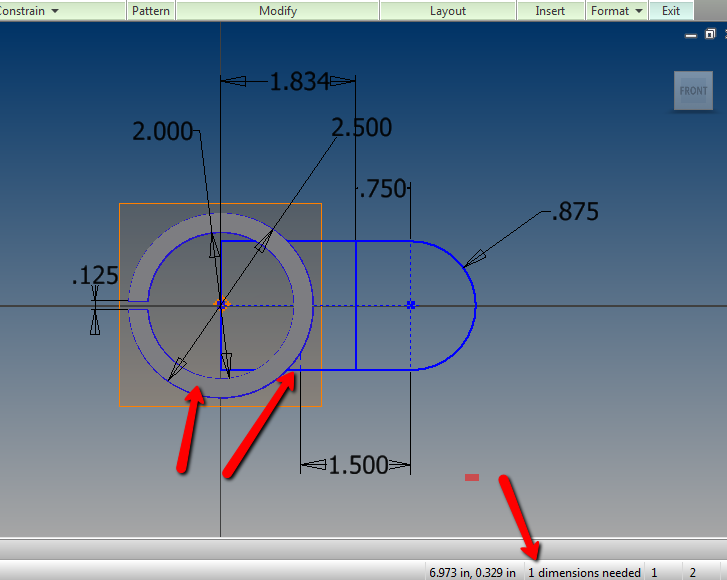

JD mather, i practiced through your drawing these are the issue that i still couldn't figure it out.
1. on my sketch 6, it said that i have one dim left, i couldn't find what it was?
2. on my Sketch 6, how can i make it show only outer circle (2.5 in Circle) instead of extruded cylinder
3. my 1.5 in dim from center of the half circle (R=.875") to the intersected with surface, the point got moved?
Roud Slotted.ipt

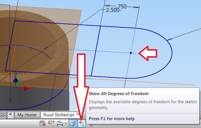

Click the Show Degrees of Freedom tool.
It will show where you are missing dimensions (in this case - you are missing a coincident constraint)
You are also missing a coincident constraint between the point and projected circle - therefore requiring extra dimension(s).

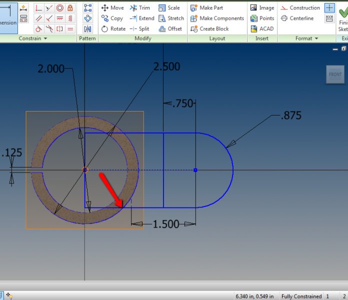

I did add the one missing dim by coincident via Degree of freedom, good tool to use. However my 1.5 inch dim was moved for some reason, i put the point on the intersection line between the round surface and line( At the red arrow)and it was measured right at the beginning, Is it a big deal? can i still extrude it?

Delete the 1.834 dimension and add a Coincident constraint between the point and the circle. Simple!

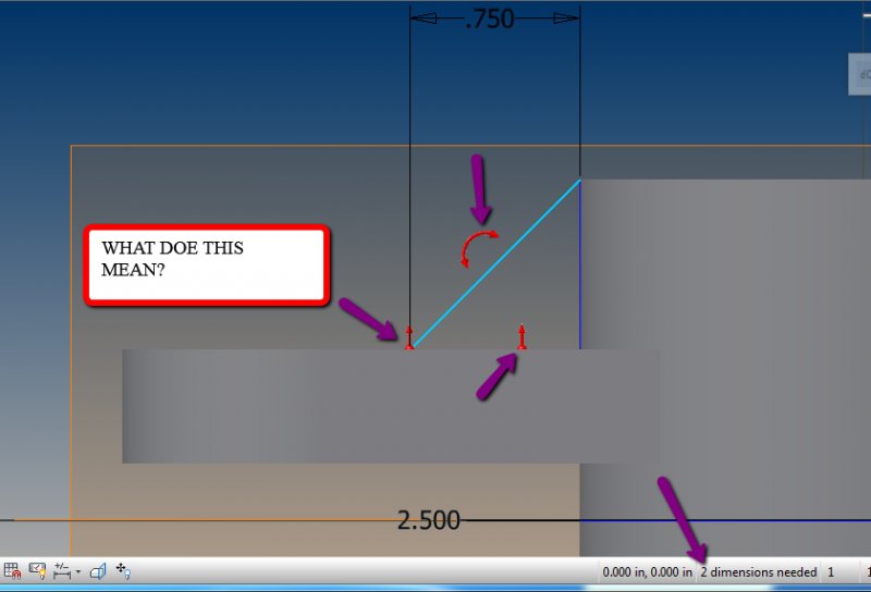

I got it, what does degree of freedom do? i can see that i can move the horizontal line up and down follow the arrow but it am still missing 2 dims.
Senga, I did not create or use that plane, it was in the part file you attached. I just ignored it and left it there. It's called workplane2 and it's offset from a workplane1 by 2.5 in. There is no need for these workplanes to create this part, and they are not used in my example/modification of the part. But if you wanted or needed to make a workplane tangent to a cylinder use Plane - Tangent to Surface and Parallel to Plane. Pick the outer cylindrical surface, then pick an origin plane or any other surface or workplane that you want the plane to be parallel too.
But if you wanted or needed to make a workplane tangent to a cylinder use Plane - Tangent to Surface and Parallel to Plane. Pick the outer cylindrical surface, then pick an origin plane or any other surface or work plane that you want the plane to be parallel too.
