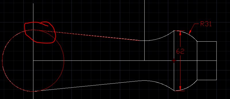

JD Mather Posted May 20, 2014 Posted May 20, 2014 Lines should be tangent to arc at left. Dimensions don't match the original drawing. Quote

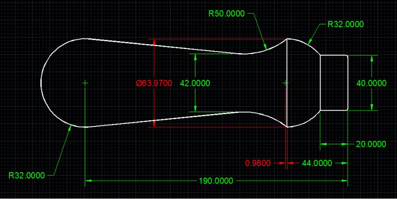

neophoible Posted May 20, 2014 Posted May 20, 2014 Yeah, there seems to be some discrepancy in the original dimensions, as though it was first done in inches, then converted to metric, so that you cannot perfectly hold all of the dimensions, e.g., Quote
JD Mather Posted May 20, 2014 Posted May 20, 2014 All of the dimensions from the original drawing can be honored out to as many decimal places as desired. Quote
neophoible Posted May 20, 2014 Posted May 20, 2014 All of the dimensions from the original drawing can be honored out to as many decimal places as desired.May be, as the original is quite blurry and a dimension has even been written in by hand for whatever reason. Quote
neophoible Posted May 20, 2014 Posted May 20, 2014 (edited) It seems to me this is another "one of those". The 64mm dim could be very misleading unless the center point is very clearly shown offset. But even then, the 64 is not a necessary dimension. Better to just leave it off. Edited May 20, 2014 by neophoible added "is" Quote

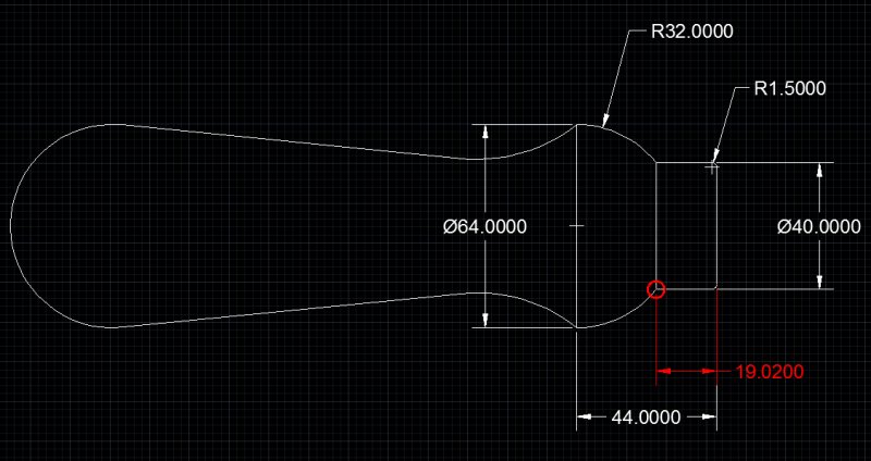

JD Mather Posted May 20, 2014 Posted May 20, 2014 The 64mm dim could be very misleading unless the center point is very clearly shown offset. But even then, the 64 is not a necessary dimension. Better to just leave it off. You are assuming that the center of the arc is coincident. Dimensions on a drawing (unless shown as reference) take precedence over all else. In typical classroom type problems these are the tricks that separate the "A" students from the "B" students. Instructors look for this attention to detail and throw in tricky stuff like this. There is nothing wrong in this part/assignment. See Post #7 where I clearly show the dimensions as given in the original drawing. Quote
neophoible Posted May 20, 2014 Posted May 20, 2014 You are assuming that the center of the arc is coincident.Dimensions on a drawing (unless shown as reference) take precedence over all else. Or maybe you are assuming I'm assuming? The 64mm is a dimension, but to what? Maybe I know, if I'm the one originating it. Experience tells me that such a drawing is too easily misinterpreted. The student should be taught to make it clear. It seems to me, this is a case where that is not the case. However, it is a good problem for demonstrating what happens when you don't make it clear. (Hmm. I wonder if anyone can understand that?) Quote
neophoible Posted May 20, 2014 Posted May 20, 2014 In typical classroom type problems these are the tricks that separate the "A" students from the "B" students.Instructors look for this attention to detail and throw in tricky stuff like this. There is nothing wrong in this part/assignment. See Post #7 where I clearly show the dimensions as given in the original drawing. I think the drawing in post #2 is more appropos to the discussion, and it isn't tricky, it's misleading or incorrect. The 64mm is not an exact dimension when holding all the others exact. Post #7 is where the solution comes in. If the student is told that the center is not along the line, that the 64mm is not exact, then you have a more bona fide problem. Or you could just drop the 64mm dimension altogether. Quote
JD Mather Posted May 20, 2014 Posted May 20, 2014 I think the drawing in post #2 is more apropos to the discussion, and it isn't tricky, it's misleading or incorrect. The 64mm is not an exact dimension when holding all the others exact. Post #7 is where the solution comes in. Post 2 and 7 are the exact same file. You are wrong, the drawing is correct. It is an exact dimension holding all others dimensions exactly as given. I am done with this one. BTW, it isn't tricky or misleading for the "A" students. Quote
neophoible Posted May 20, 2014 Posted May 20, 2014 Post 2 and 7 are the exact same file.You are wrong, the drawing is correct. It is an exact dimension holding all others dimensions exactly as given. I am done with this one. I never suggested they aren't from the same file. But it is too obvious that they do not show the same information, that is, #2 does not even come close to indicating the offset center for the R32 dimension that #7 does. What is not clear is where or how the 64mm dimension applies. This was not answered. As far as I can tell, my 63.9700, while not exact, is correct to 4 decimals and, as far as I can tell, nothing has been posted thus far to demonstrate differently. If someone would like to show a more correct solution, that might prove useful for other students looking for help. I don't mind being wrong, especially if demonstrating such helps someone else. I sense there may be a fundamental difference in what the goal should be here, and that may very well be up to the individual teacher and class situation. As usual, I'm looking at it from my own real world perspective where those receiving drawings need clear information so that they can efficiently and correctly create the part. Students definitely need to be very aware of this, but, from what I can tell, this problem does not directly demonstrate it. However, in a classroom, where students are trying to solve problems, perhaps even including those involving illustrations by sloppy designers, tricks may very well be the way to go. Quote
neophoible Posted May 20, 2014 Posted May 20, 2014 As a tricky problem, maybe it's OK. But now that I see what the solution likely is, we'd probably fire someone who designed like this on the job. While the problem is solvable, I seriously doubt the original intent was other than straightforward. Again, this is another "one of those". For students looking at this, the center point location is approximate to 4 decimals. If your teacher really wants such a solution, you will have to solve it graphically in CAD. Quote
eldon Posted May 21, 2014 Posted May 21, 2014 I would like to offer a few comments, that may be at variance with some previous. For this exercise, units do not matter. Geometry is the same shape whether it is in millimetres or inches. This is a drawing exercise. Finally, I see that someone has eventually twigged that the centre of the 32 arc is not on the centreline. What is given are two fixed points, with an arc passing through them. The usual way of ensuring this geometry is to strike an arc from each point, and where they intersect is the centre of the required arc. There is no need to know further dimensions, whether to zero places or eight places of decimals. That is just unnecessary confusion for a geometry exercise. Quote

ducky29 Posted May 21, 2014 Author Posted May 21, 2014 Guys I just gave the drawing to my teacher, and he accepted it.Thanks a lot for your help. Quote
