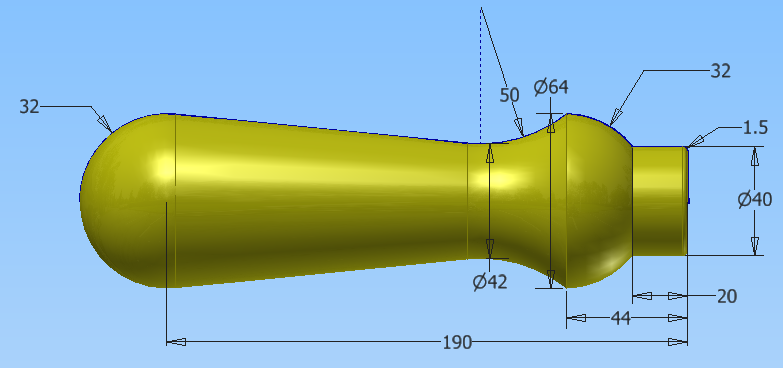

Hello everybody :)
I m new to this forum.I just want to ask what commands do I use to finish my drawing
Im having problems wih the highlighted part.Hopefully the quality is good enoughLcaqMGKh.jpg

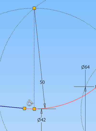

Attach your dwg file here of what you have attempted so far.
You could try using the Circle command and the Tan-Tan-Radius option.

I tried the fillet command(radius 50) but it didnt work.

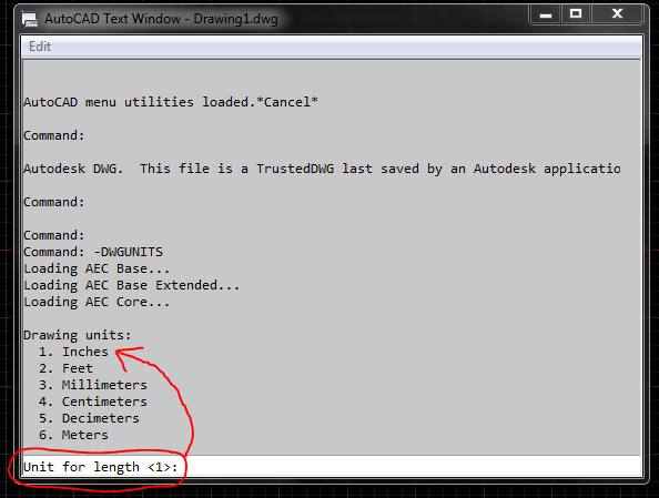

The drawing is supposed to be in millimeters not in inches. Image if you will that you had a handle that was 190 inches long versus one that was 190 millimeters long. At 190mm that would be a little over 7" inches long.
Use the acadiso.dwt template file not the acad.dwt to start your new drawing.

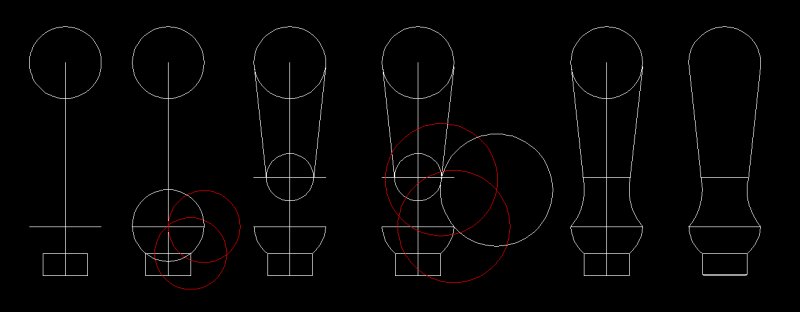

A quick mockup using some temporary geometry.

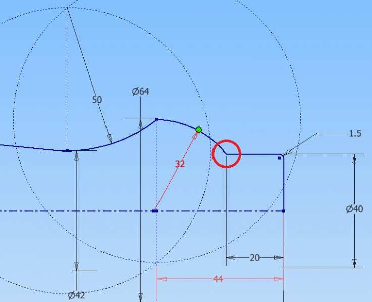

Your R32 arc in wrong location.
[ATTACH]48987[/ATTACH]
Thanks .I already fixed that but unfortunately I uploaded the wrong file.
@Remark the drawing its in mm not in inches.

"@Remark the drawing its in mm not in inches."
If that is true why when I run the -dwgunits command it reports back the following?
If you are happy working the way you are then by all means keep at it. Good luck.
reMark, How do you know where the 42-dimension is? That is, where the radius 52 is suppose to end?
[ATTACH=CONFIG]48995[/ATTACH]
Im pretty sure I set the units to mm.(used _units command)

Line tangent to arc.
Dimension at min distance. (71mm from centerline of part)
Im pretty sure I set the units to mm.(used _units command)....
Are you using AutoCAD 2005 as indicated in your profile? Does r2005 support the -dwgunits command?
Yes im using 2005 version. When I type _dwgunits it pops us the same window as in Remark's post.
Here is what I have done so far.
What command do I have to use to make the corner "smoother" (R 1,5)?
I cant get it done by using chamfer.
d1.dwg
When working in metric units I suggest you use a metric template file such as acadiso.dwt rather than the default acad.dwt.
You can round off a square corner using the FILLET command and indicating the radius you would like AutoCAD to use.

.... When I type _dwgunits ....
That is not the same as what I wrote. I wrote -dwgunits, not _dwgunits.
