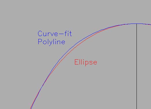

JCAMP17 Posted December 5, 2008 Posted December 5, 2008 Ok. We are creating a custom table here at work. My boss wants a specific width and length of an oval table....when i create an ellipse you are restricted to a certain curve that he does not like....I will attach this drawing to help try to make better sense. If any of you guys have any great ideas please let me know. Thanks much. p.s. hes getting pissed at me lol _1205110549_001.pdf Quote

lpseifert Posted December 5, 2008 Posted December 5, 2008 better pissed off than pissed on... If he can't live with a true ellipse, try creating it with a Spline, it'll take some fooling around thogh. Quote

eldon Posted December 5, 2008 Posted December 5, 2008 If you draw a closed polyline through the four major points, then curve-fit, you get a different line to the ellipse Quote
JCAMP17 Posted December 5, 2008 Author Posted December 5, 2008 thanks eldon im gonna try that but exactly what are the steps to doing this? Quote
eldon Posted December 5, 2008 Posted December 5, 2008 First draw the major axes, that is a vertical line of 10', and a horizontal line of 6'-6" so that the mid points of each line are together. Then start a polyline from one end point, then draw the line between end points in order, until you get to the fourth point. Then complete the polyline using the Close option. Then start PEDIT, pick the polyline and use the Fit option. Job done Quote

eldon Posted December 5, 2008 Posted December 5, 2008 all right im really sorry but youre losing me when you say "then draw the line between end points in order" sorry if im just dumb its been sorta a stressful day OK, I didn't know at what stage you are with AutoCAD. Get your OSNAP set to Endpoint. Then start the Polyline and draw between the endpoints of the major axes in order. Read the command line at the bottom of the screen and it should come out. Quote

rkent Posted December 5, 2008 Posted December 5, 2008 Draw one quarter of it with the spline command, turn splframes on, adjust to what you want, mirror the rest. The more picks making the spline the more you can control it. Draw center lines, then off set them multiple times, draw an ellipse as a guide, trim the offset lines outside the ellipse to get started on end points to use for the spline. Also, draw a rectangle, pedit, spline. It will get you close enough to then draw a spline at the end points. Quote
