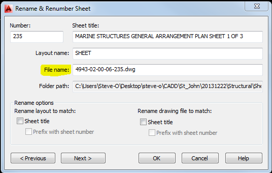

I'm shocked you haven't gotten more replies regarding the awesomeness of ssm. Maybe I missed something regarding the issues you have.
You can change filenames, layout names, sheet numbers, sheet titles, dates, revision numbers, and more through the ssm. And that's without even getting into the custom properties. With custom properties and fields you can fill out your entire revision block through the ssm without even opening the drawing. It's even better if you have the ssmpropeditor from JTB world (hope I spelled that right). With that tool you can change multiple sheets at the same time. Note that to change the filename the drawing has to be closed, just like if you were to do it through windows explorer.
Printing is about 100 times easier using the ssm, for regular cad users and non cad users. Because in the ssm you see a list of drawing numbers and titles, select the ones you want, right click => publish => publish using page setup override => select your page setup, and you're done.

You can change filenames....
I never knew SSM to alter the physical file name when you renamed it from the SSM. Did something change, or was I simply not doing something correctly?
You probably had the file open. In the "rename and renumber" dialog there is a field for filename that will be greyed out if it's open. In fact, when using sheetsets, the ONLY way you should rename a file is through the ssm. Otherwise the ssm won't find it and you'll have to repath the renamed sheets one by one. It's similar to repathing an xref, but without the benefit of Reference Manager.
No file open... that was the most obvious thing I tried first years back. I'm telling you, I've tried and tried and never saw the Sheet Set Manager physically rename the file in Windows Explorer after a file was created.

Hmm, that's odd. Was the filename field typeable (i.e. not greyed out)? The rename/renumber dialog has been pretty much the same for as long as I've been using it, since 2007 (I think). Sometimes the ssm takes a bit to "unlock" the file after it's been closed. I'm pretty sure there is system variable that controls how frequently the ssm updates, but I don't know if that affects the lock status. Just throwing out guesses, because it's always worked over here (using Vanilla and Civil3D). If I did this right, this is what my dialog looks like:
File Name text field is new. I've never seen that before.
Project Navigator has an XML file attached to every DWG which is how it controls the auto-file naming in Windows Explorer (I think). Plus it's way more robust. If the File name field is now there in the SSM, then it definitely makes for a better setup than before, but even with this feature the SSM still lacks in so many areas.
