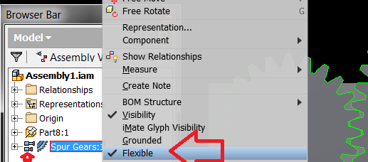

Faouweb Posted May 16, 2014 Share Posted May 16, 2014 Hi, How can I rotate a Spur Gear as you can see on the picture. http://s3.postimg.org/wbwxx2soz/rotation.png Thank you Quote Link to comment Share on other sites More sharing options...
JD Mather Posted May 16, 2014 Share Posted May 16, 2014 Add an angle constraint and then Drive Constraint or in Environments>Dynamic Simulation add a Rolling Cylinder on Cylinder joint and then Imposed Motion on Revolution joint. If you can't figure it out - simply attach your assembly here. Quote Link to comment Share on other sites More sharing options...

Faouweb Posted May 19, 2014 Author Share Posted May 19, 2014 (edited) Hi Mather, The file is a little bit big and I can not attached it, I used Pack and go but is still big. I will put the Assembly and the Part in the attachment. Here is what I have. I did not installed it my self, we have a staff in the company which have access in order to install or modify applications. ---------------------------- Edit --------------------- Is there a step by step tutorial to do it ? Thank you Part1.ipt Design Accelerator.zip Assembly1.zip Edited May 19, 2014 by Faouweb Quote Link to comment Share on other sites More sharing options...
JD Mather Posted May 19, 2014 Share Posted May 19, 2014 Step 1 Right click on you Design Accelerator sub-assembly and set it to Flexible as shown below. You should now be able to drag the gear motion. Next I will demonstrate how to Drive the motion. (also notice in the image above your assembly references Part8, yet you attached a Part1?) Quote Link to comment Share on other sites More sharing options...
Faouweb Posted May 19, 2014 Author Share Posted May 19, 2014 Thank you very much JD Mather , I can rotate the Gear Quote Link to comment Share on other sites More sharing options...
