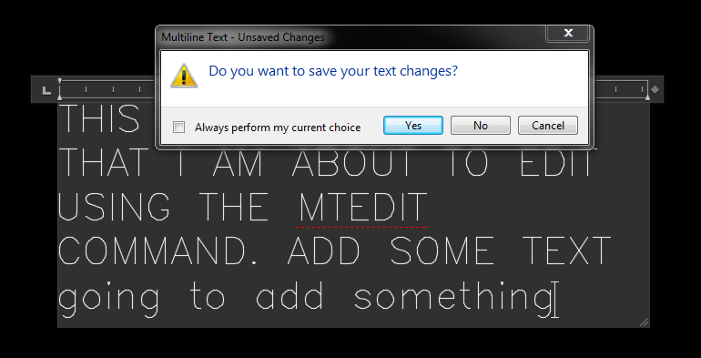

Is this what you are after?
If so, there is no need to reinstall AutoCAD. Hit the ESC key instead.
Well, I duplicated your problem without knowing the solution first. That can be a mistake. Thankfully, I found that you can change it in Options > System> Hidden Messages Settings > AutoCAD > Multiline Text
For those who want to cause the problem, just be sure to check "Always perform my current choice" before choosing (see ReMark's attachment above).
Oh, one tidbit I found interesting is that it isn't in the list until you set it to "Always...", presumably because it is not hidden until that point.
@ ReMark: Yep, I always, upon first session of a new CAD install, click "NO" & "ALWAYS PERFORM MY CURRENT CHOICE", and on a few occasions over the years have hit "YES" instead, along w. "ALWAYS......", and once again did it yesterday :reallymad:
