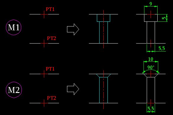

Pick up two point, draw a countersink, two kinds , M1 & M2.
I hope it can be extended. can modify parameters in code (9,10, 5,5.5 THAT FIGURES )
Can Dynamic drawing?

Hi ,
If the two types are in the same sizes all the time , you can create a block for each shape and that would be easy to modify later on if needed .

Thanks , Tharwat, nice to meet you !
The length of the hole is uncertain,use block is unsatisfactory.
I have other ideas,This is a basic, I want extended.
The size of the hole is many, so In the late ,I will use DCL, add data.........
Also if only the length of the Sink is vary , you can make them in a Dynamic Block with length parameter for the length only . just an idea .

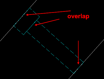

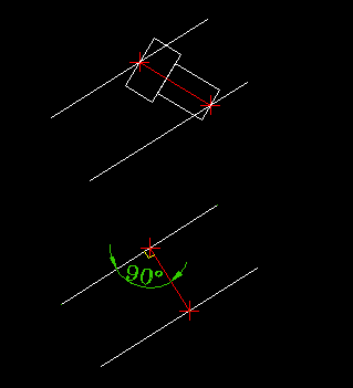

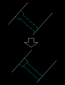

Can Vertical restrictions ?
Check this out .
Ok, when pick up the pt2, I can use "PER" to osnap,
In addition, can use "LINE" to draw this ? because……
This ?

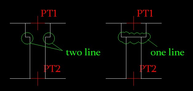

sorry ,The problem of #15, I can't solve
What is that problem ? You want to add one more line as per the highlighted one in your post # 15 ?
Your routines is draw 6 line , I want 5 line
Just replace the following line of codes from the previous routine in post # 14
(mapcar '_l (list 4p 5p 7p 9p 6p) (list 5p 6p 8p 10p 3p))
