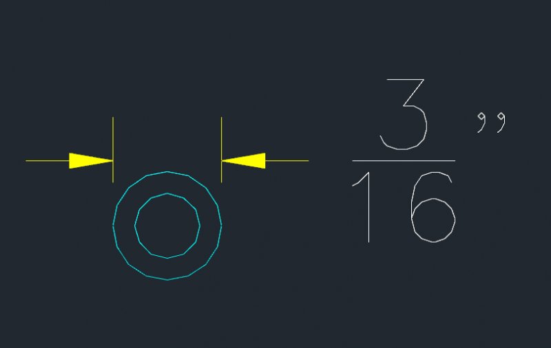

I would like to create each of the symbols(shown below)and nest them into generic fixtures, receptacles, panels and switches to place in my projects so that I can have a construction documents with consistent symbols.. I've used symbolic lines to show the symbols that don't need to scale, a 2x4 troffer light for example, but I have no clue how to add scale-able symbols and have them come into my projects at the correct size depending on the view scale. I've searched this forum and others and haven't found any clear explanation on how to go about this.
Can anyone explain in the simplest terms possible how one might go about this?
My company uses two scales 95% of the time - 1/4"=1' and 1/8"=1'
I'v attached an image of our symbol for a recessed down-light and the size it should appear at 1/8"=1' scale. I'd like to nest it in the RFA I've attached and have it show correctly at 1/8"=1' and scale down if placed on a sheet at 1/4"=1'.

Use Generic Annotations Families. Technically they are suppose to have text but don't use text at all, just draw 2D linework in them at a 1:1 scale for a sheet of paper. Then you nest this into your Electrical Family, Lighting Fixture Family or whatever Family it calls for. In Plan View, use the Visibility Settings to only show the nested Generic Annotation Family, hiding the 3D models completely so all you see is a "2D schematic symbol" that will also scale.

Thanks TZ - I really appreciate the clear explanation. I'm using GA's now and they are working fine, not sure how I missed that.
