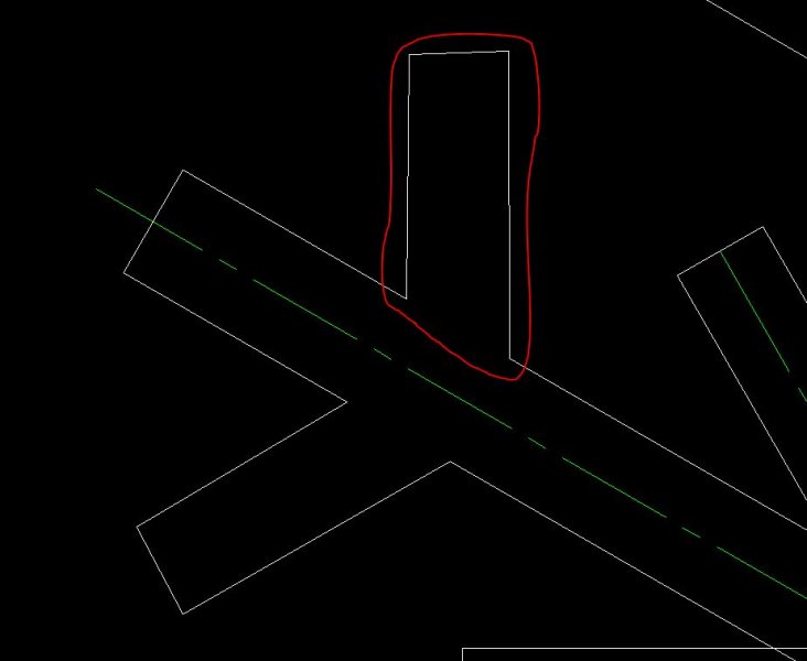

fishwater71 Posted May 8, 2014 Posted May 8, 2014 Having issues getting the smaller section done. The branch width should be 3/4. I have the angles correct at 60. Thanks for the help. Final project-snowflake.dwg Snow Flake drawing.pdf Quote

ReMark Posted May 9, 2014 Posted May 9, 2014 (edited) Can't trim? I suspect it has something to do with the fact that the new version of the ARRAY command groups all the geometry into a block. Explode and trim. When you are done trimming run the Overkill command on your snowflake. You may discover you have a few duplicate and overlapping lines. OK will clean them up for you. Done. I went back and took another look at your drawing. It appears that the two short arms that angle off either side of the long arm are not the correct width. Yours have a width of 5/8" but the PDF shows a width of 3/4". You are going to have to fix that. Edited May 9, 2014 by ReMark Quote
ReMark Posted May 9, 2014 Posted May 9, 2014 Something doesn't look quite right here. Notice the jaggies? Might want to check the angles on these lines (change your angle precision to 0.0000). Did you mirror one arm to the other side or did you construct the one circled above independently? Quote
fishwater71 Posted May 9, 2014 Author Posted May 9, 2014 Thanks Remark. I mirrored the left side off of the right side. lol Will post results again in a bit. Quote
