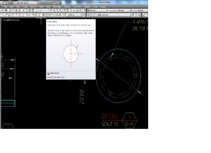

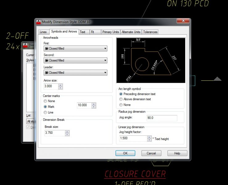

Center Mark command, change scale through dimension style manager.

Another way is to have a dim style with one extension line being a center line.

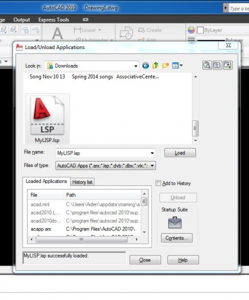

It looks like i got the lisp file install succesfully. now i opened up Autocad, i have 3 circles on the screen and what is the lisp command prompt to use for center line?
You call the lisp at the commandline with CL.
Remember to switch to the layer upon which you want the centerlines to be created
before running it.
You call the lisp at the command line with CL.
Remember to switch to the layer upon which you want the center lines to be created
before running it.

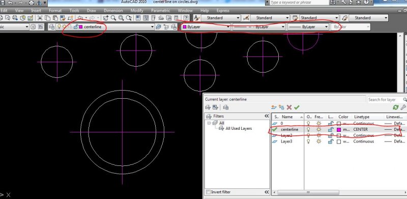

I switched to one layer called " Center line", i typed CL--select objs then i selected multiple circles then entered, i can see the center line was placed automatically one by one, How come the center line didn't show as center, they look like contentious lines, do i fix that by LTS or am i missing some steps?
Work great so far I can see a light at the end of the tunnel Lol.
The lisp will create lines indicating the middle of the holes, on whichever layer is current, and the linetype used for them will be the linetype which
is assigned to that layer. I should think that the Line Type of a layer named Center line would most likely be CENTERLINE.
If you open your layer properties manager you can check the layer definition, and if you need to, you can change the linetype of that layer to centerline
in the layer properties manager.

Layer defination on layer properties assigned as centerline but the center lines on circles did not appear as center line.
Then your problem is LTS (linetype scale), try adjusting that.
Write LTS at the commandline, it will reply with a number representing your current linetype scale.
To change it, just enter a new value, and hit ENTER.
You may need to REGEN, if you don't see an immediate change in the line display.
