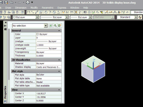

Yeah, I was able to reproduce the OP's original problem, but in doing so discovered a way to reproduce the a problem where 3D object's geometry becomes disassociate with it's display, which has been a problem for several releases, I just couldn't reproduce it.

The scaling problem doesn't exist in 2014 (and earlier) as far as I know, but the issue where 3D objects geometry become dis-associated with their display had been around since 2012. It just so happens that this new scaling problem in 2015 also causes the previous display issue.
Here's a sample in ACAD2013 format, if you want to test in 2013-2014.
3D Solids display issue.dwg

Bad enough to consider it only a display glitch, but if exported (AcisOut) and re-insert - the same or different file - the new geometry is set at that erroneous position. :o

No it doesn't just affect primitives... I used the simplest 3D object available in AutoCAD (a primitive) because it demonstrates the problem at it's most basic level.
LOL at putting "problem" in quotes. I'd like to see how you felt about it if you opened your drawings one morning and found parts and pieces being displayed far away from their actual location. Autodesk's solutions so far (2013-2014)
1) EXPLODE then UNDO, which will "fix" the double display, but also leaves the object in the wrong position.
2) delete the object and re-create from scratch. Fabulous!

The file I posted was created in AutoCAD2015 using the procedure shown in the screencast. AFAIK, 2014 doesn't have that particular scale problem. I have however in the past been able to cause the display issue in AutoCAD2013-2014 via Drawing Views (VIEWBASE).
I can reproduce the problem in 2014 IF it involves a primitive. Any other 3D object I create from scratch does not appear to suffer the same peculiarity.
