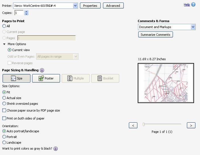

That is strange. In my Adobe Reader, I can zoom into an area, or set the zoom factor and scroll.
Then in the Pages to Print section of the Print dialogue box, click on the More Options, and you can print Current View.
I agree with Eldon, I had a private thing and needed a Pdf of an exact size, to fit a table top laminated, so just played with scale factor till exact size. Laminated and put on table impressed a number of people. Even print to a new pdf image required then reprint at scale.
Although your solution wasn't quite the answer as using the 'fit' option overrides the scale but by using the print current view did help as I was then able to roughly pick the area needed and then by setting the scale it printed what I needed.
Thanks for your help
