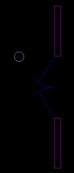

hisdiamond Posted April 25, 2014 Posted April 25, 2014 (edited) Hello everyone, This is so ironic, I'm needing some help on the same project. (This thread was up 4 years ago from another student)The only difference is that the rocker is optional. So let's concentrate on the door symbol. I layered my wall blue and my doors red just as it show on the example drawing. My challenge is making sure I put in the correct units to get the correct dimensions. The doors have to be 2'6" wide and 6" thick. The Arc to use is 3 points. So where do I begin? Edited April 25, 2014 by hisdiamond corrections Quote

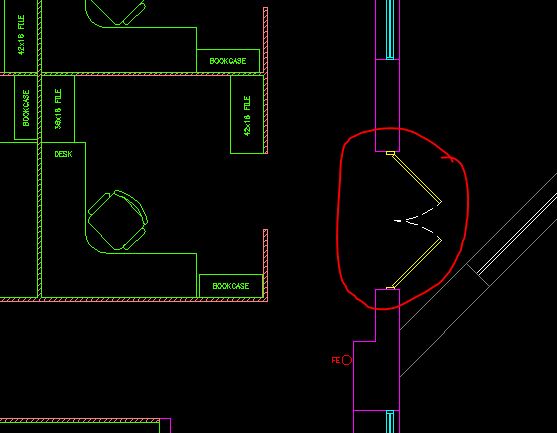

ReMark Posted April 25, 2014 Posted April 25, 2014 Is this kind of what you are asking about re: how to show a double door? Quote

ReMark Posted April 25, 2014 Posted April 25, 2014 The posting with the exact drawing was in April 2010 from a Numerics.... Yeah, I found it. I don't see what problem you could possibly be having. The double door sketch is quite simple. You draw a rectangle, a single line and an arc then you mirror the three objects. Done. Lines drawn at angles can be done in a few different ways. Was this not covered in class? Same goes for arcs. If it comes right down to it you could draw a circle and a couple of temporary lines to trim away the portion you don't need then erase the temp lines. What exactly are you stuck on? Quote

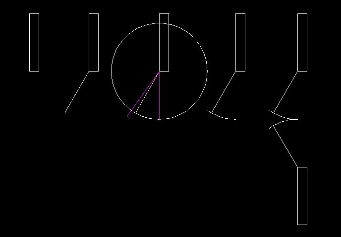

ReMark Posted April 25, 2014 Posted April 25, 2014 This is the sequence I recommend you follow. It uses the Rectangle, Line, Circle, Trim and Mirror commands. To draw the line for the door start the line command then for your input type the following exactly as shown: @30 The two magenta lines are there solely for trimming out the circle. One of them is vertical; the other can be any angle you choose. Got it? Good. Now go do it. Post an image of your results after you have completed the drawing. Quote

ReMark Posted April 28, 2014 Posted April 28, 2014 To recap, all you have to do is draw a single rectangle, representing your wall, a single line, representing one half of the double door, and a arc. Once those three objects are created then mirror them using the endpoint of the arc that lines up with the bottom left hand corner of the wall. Before you start make sure that 1) Othomode is enabled for the wall, and 2) that you have your OSnap settings already defined and enabled. A slightly different way to approach the drawing would be to draw the rectangle for the wall. Next, draw a line straight down at a distance of 30. Use the Rotate command to rotate this line -45 degrees (the basepoint of the rotation is the end at which the line is attached to the wall). Draw a circle with a radius of 30 using the same basepoint. Draw two temporary lines to use for trimming the circle (see my previous image). When done, erase the two lines and mirror what remains. Done. Quote
