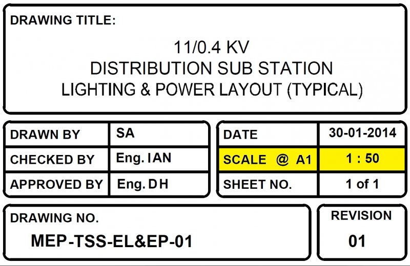

In attached image you find the scale of diagram.
That diagram I received in PDF format. I just print it on plotter by selecting the paper size A1 the scale is exactly accurate.
But now I have got CAD file also. I just want to convert the exact diagram on A3 paper so that scales remains the same.

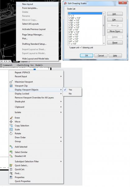

I just confused. If I have diagram only on model then what to do and how to shift model into Layout and scale it as desired.
By right clicking into the model I created the Layout but set scale from where (see figures).
I want to test that. Please help.

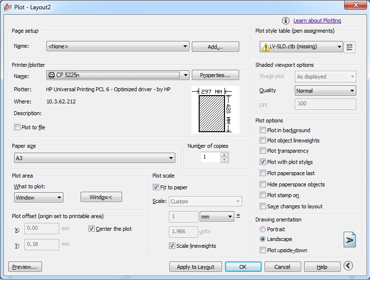

But I am only asking about the procedure of printing on specific scale. From where start and from where ends.
My simple question is if I use only plot command select a paper and specify the scale so the printer prints it or also needs to do some additional work like set units (Imperial, International etc).
eldon explained the procedure. Draw everything in model space at full size, switch to your layout, create a viewport, position your objects, assign it a scale and make sure you lock the viewport display so you do not inadvertently change it.. When done print the drawing and where it says "What to plot" make sure it says Layout (should be the default). Drawings are plotted at 1:1 scale meaning 1 mm = 1 unit. AutoCAD will automatically plot whatever is displayed in the viewport using the scale that was assigned.
We assume you started your drawing using a metric template like acadiso.dwt and not the default imperial template named acad.dwt.
A shortcut, that I have seen mentioned, is that an A1 drawing can be printed on an A3 at half the scale. This is the only one where it happens conveniently.
The procedure is to make the custom scale to be 1mm = 2 units (edit the 1.966 figure to be 2 exactly).
You will end up with the A1 shrunk by half, although the title block will still say that it is an A1 at 1 to 50, when it is on A3 paper at 1 to 100.

His paper size is wrong if he wants to print to an A1 size. Currently he has A3 selected in the page manger box.
Took a second closer look. Your entire layout is messed up. Wrong paper size, plot style missing, landscape instead of portrait, fit to paper is checked. I would just delete that layout and start a new one. Your main problem will be your title block. If your title block is drawn to fit an A3 size then you cannot not use it for an A1 because it wont fit unless you edit your title block to fit it. I think there's a couple of tutorials here somewhere that can help you with setting up a layout.

And in fact, the OP IS using a metric template and has not got the Plot style table because of an omission by the sender of the drawing.
