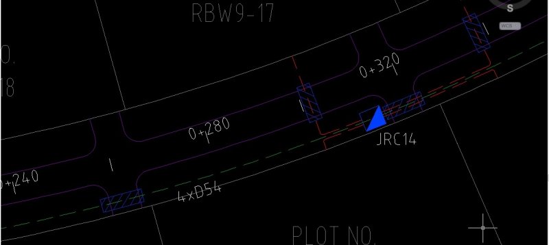

tipu_sultane Posted April 23, 2014 Posted April 23, 2014 (edited) I want to break a polyline into multiple polylines from one specific point to another. A single polyline into multiples polylines. Edited April 23, 2014 by tipu_sultane Quote
Spaj Posted April 23, 2014 Posted April 23, 2014 I want to break a polyline in specific point. Have you tried the BREAK command? Read the HELP on the various options, especially how to BREAK at a specific point. Quote
tipu_sultane Posted April 23, 2014 Author Posted April 23, 2014 Yes I used it but it deletes the portion of line. I just want to separate one line into multiples so that the total dimensions don't disturb. Quote
ReMark Posted April 23, 2014 Posted April 23, 2014 How are you going to define the points at which the polyline will be broken? All they equally or unequally spaced? Quote
tipu_sultane Posted April 23, 2014 Author Posted April 23, 2014 No I just want to count the length of pipe on some network. Which are 1-way, 2-way, and 3-way. You can find the two color line red and green in the attached image. When I select the say green line as a result the selection of entire green line. I just want to break the line where there only one green line existing and find its length using area or list command. Similarly to find the length of one line among with two parallel and multiply by two. Any way If there is another easy method exist to find the length of lines separate on the basis of ways (1-way, 2way, and 3-way) then help me. Quote

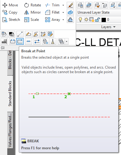

CADgirl Posted April 24, 2014 Posted April 24, 2014 Why not use break at point instead of break? Quote
