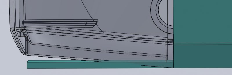

mutski Posted April 23, 2014 Posted April 23, 2014 Hi all Sorry if this is a repost, I posted this question yesterday, but it seems to have disappeared. I'm trying to extrude at an angle, but I only seem to be able to get it to work at 90 degrees to the surface I'm working on. Google doesn't seem to be able to help me (or I'm typing in the wrong keywords). I've taken a screen capture of what I'm trying to do. The green is the current part I'm editing. I want the long green flange at the bottom to line up with the grey transparent part. At a rough guess it's about 20 degrees, but I can't find any options to get the extrusion at anything other than 90. Any ideas? Using Solidworks 2010. - Cheers Matt Quote

mutski Posted April 24, 2014 Author Posted April 24, 2014 For some reason it won't let me upload files here. Keeps saying it's uploading, then after about a minute it says failed. http://www.pwcau.com/SW/Multicharger.zip I've uploaded the file here. You will see there is a part called Charger Rear, Bottom Housing, and Charger Front. Basically we are taking an existing product which is a charger module, and turning it into a 6 way charger. We want to use the existing front and back, and then insert a new piece (bottom housing) which will extend it. I'm having trouble getting an extrusion to line up with the angle on the rear and front housings. Hope that makes sense. Cheers - Matt Quote

Mike_Taylor Posted April 25, 2014 Posted April 25, 2014 You're best bet is likely to use the sweep command. Create a construction line from a corner of the profile you are trying to extrude and sweep the profile along this path. I am doing this solely from memory, I haven't touched Inventor or Solidworks on over 5 months now. Quote
JD Mather Posted April 25, 2014 Posted April 25, 2014 I'm more interested in learning how to do it myself rather than just having you do it. Anyway thanks for your help. Matt I would go about it in a completely different way. Unfortunately the easiest way to communicate the solution would be from the part Feature Tree, but I am not even sure the techniques I would use in r2013 were available back then. Quote
