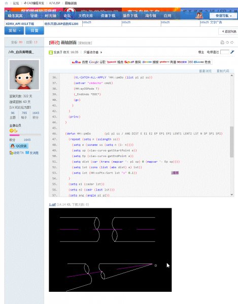

  Tharwat said:
If that routine is yours , post the codes .
Sorry ,Tharwat, No offense.
It's not mine, just a little suggestion.
I find the source code at here:
http://bbs.xdcad.org/thread-673470-1-1.html

Anyone get this lisp to work in Acad 2008 or before version. I get no error, but not working either. Steve
highflybird,
There is some function missing from your code namely "HH:ssPts:Sort" and "HH:ayOSMode"
Also since you are filtering polylines to a length of 2, this would means that it needs to be
exploded. ???
I also doubt very much that this code ad the one shown on the animation are the same.
ymg
Edited by ymg3
Yes, the code is the same, but I had to modify it - to add missing subfunctions; to add POLYLINE option (ymg, yes I had to explode POLYLINE)...
Here is my version :
(defun C:w1 (/ *error* CMD1 FIL OSM1 P1 P2 SS SSS)
 (defun *error* (msg)
   (vl-bt)

Marko,
Good job!, but you are generous when you say the code is the same. :)
ymg
  ymg3 said:
highflybird,
exploded. ???
ymg
Sorry , The author published the code that's it.
I find the author before release function.
(defun HH:ayOSMode (isOpenSnap)
(if isOpenSnap
 (setvar "osmode" (rem (getvar "osmode") 703));
 (setvar "osmode" (+ (rem (getvar "osmode") 703) 703))

Hi, marko ,nice! we are so proud of you.
I think there is another situation. about tube break.
Edited by highflybird
Thanks marko_ribar & highflybird ,Thank you for your attention.Thank you for your help!
And Thanks Tharwat, You are the best.
If can break tube, It will be very perfect.
Edited by liuhaixin88
