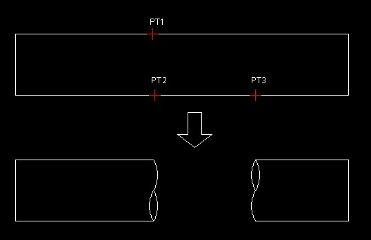

Thanks Tharwat, but how to do thiis ,my Thread. break in middle . (Maybe line or pline)

Try this routine that I just wrote for you purpose .
(defun c:test (/ pick p1 s1 p2 s2 p3 s3 p4 s4)
 ;;    Tharwat 24. Apr. 2014        ;;
 (defun pick (p / s)
   (if (not (setq s (ssget p '((0 . "LINE,LWPOLYLINE")))))
     (progn (princ "\n Should pick a point on Line or Polyline !") nil)
     t
   s
 (if (and (setq p1 (getpoint "\n Specify first point on [Line,Polyline] :"))
          (setq s1 (pick p1))
          (setq p2 (getpoint "\n Specify opposite point :" p1))
          (setq s2 (pick p2))
          (setq p3 (getpoint "\n Specify parallel point to first point :"))
          (if (and (setq p4 (polar p3 (angle p2 p1) (distance p2 p1)))
                   (setq s4 (pick p4))
                   (equal (cdr (assoc -1 (entget (ssname s1 0)))) (cdr (assoc -1 (entget (ssname s4 0)))))
            t
            (progn (princ "\n No line found in Point number Four !") nil)
          (if (and (setq s3 (pick p3))
                   (equal (cdr (assoc -1 (entget (ssname s2 0)))) (cdr (assoc -1 (entget (ssname s3 0)))))
            t
            (progn (princ "\n Second and third point must be picked on the same Line or Polyline !") nil)
   (progn (defun Breakline (p1 p2 / a d f g h j k i p3)
            (setq d (distance p1 p2)
                  a (angle p1 p2)
                  f (polar p1 (+ pi a) (* 0.5 d))
                  g (polar p1 a (- (* 0.5 d) (* 0.25 d)))
                  h (polar g (- a (* pi 0.5)) (* 0.25 d))
                  k (polar p2 a (* 0.5 d))
                  j (polar p2 (+ pi a) (* 0.25 d))
                  i (polar j (- a (* 1.5 pi)) (* 0.25 d))
            (entmake (list '(0 . "LWPOLYLINE")
                           '(100 . "AcDbEntity")
                           '(100 . "AcDbPolyline")
                           '(90 . 4)
                           '(70 . 0)
                           '(43 . 0.0)
                           (cons 10 (list (car p1) (cadr p1)))
                           '(40 . 0.0)
                           '(41 . 0.0)
                           '(42 . -0.414214)
                           (setq p3 (cons 10 (mapcar '(lambda (x y) (/ (+ x y) 2.)) p1 p2)))
                           '(40 . 0.0)
                           '(41 . 0.0)
                           '(42 . 0.498582)
                           (cons 10 (list (car p2) (cadr p2)))
                           '(40 . 0.0)
                           '(41 . 0.0)
                           '(42 . 0.498582)
                           p3
                           '(40 . 0.0)
                           '(41 . 0.0)
                           '(42 . -0.498582)
          (if (and (Breakline p1 p2) (Breakline p3 p4))
            (foreach x (list (list s1 p1 p4) (list s2 p2 p3))
              (vl-cmdf "_.break" (car x) "_F" "_non" (cadr x) "_non" (caddr x))
Edited by Tharwat

Thank you very much! Tharwat, You are my god!
I do not know how grateful you, you help me too much! :beer:
