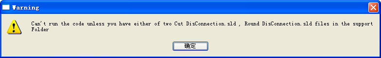

liuhaixin88 Posted April 22, 2014 Author Posted April 22, 2014 Tharwat said: Try this and it may help . Right clock on the PDC.rar file and go to General tab and on the left down hand side there must be one button Unlock press it and Apply then Okay . Then extract the folder to any destination you want and let me know . Finally the download is complete. but con't run. two sld file and pdc.vlx in the Support Folder .(E:\Program Files\AutoCAD 2010\Support),appload "pdc.vlx" and run "pdc" Always pop: Quote
Tharwat Posted April 22, 2014 Posted April 22, 2014 As I have mentioned before you should add the Slide images and if you add the .vlx file , it is okay and up to you . Quote
liuhaixin88 Posted April 22, 2014 Author Posted April 22, 2014 Tharwat said: As I have mentioned before you should add the Slide images and if you add the .vlx file , it is okay and up to you . How to add the slide images? Round DisConnection.sld & Cut DisConnection.sld and PDC.VLX together in support folder. Quote
Tharwat Posted April 22, 2014 Posted April 22, 2014 liuhaixin88 said: How to add the slide images? Round DisConnection.sld & Cut DisConnection.sld and PDC.VLX together in support folder. The .vlx file is not important but the slide images should be cut and paste in Support Folder and that is it Quote
liuhaixin88 Posted April 22, 2014 Author Posted April 22, 2014 Tharwat said: The .vlx file is not important but the slide images should be cut and paste in Support Folder and that is it Yes ,I am sure to do that, two sld file in support floder !but always pop error dialog. Quote
ReMark Posted April 22, 2014 Posted April 22, 2014 It took me all of 30 seconds to find, download, extract, and move the three files, then start AutoCAD, appload the command and run it. Worked the first time out in AutoCAD 2010. You must have done something wrong. Are you sure the two slide files are in the right folder? Quote
Tharwat Posted April 22, 2014 Posted April 22, 2014 Thank you Remark for your test , highly appreciated Quote
liuhaixin88 Posted April 22, 2014 Author Posted April 22, 2014 ReMark said: It took me all of 30 seconds to find, download, extract, and move the three files, then start AutoCAD, appload the command and run it. Worked the first time out in AutoCAD 2010. You must have done something wrong. Are you sure the two slide files are in the right folder? Thank you for your test. I am sure to do that, two slide in "E:\Program Files\AutoCAD 2010\Support" , My cad Installation path "E:\Program Files\AutoCAD 2010\acad.exe" Quote

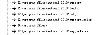

liuhaixin88 Posted April 22, 2014 Author Posted April 22, 2014 This is my Support File Search Path: Quote
Tharwat Posted April 22, 2014 Posted April 22, 2014 After adding the two slide images go back to Autocad and copy and paste the following into your command line and let me know the outcome . (findfile "Round DisConnection.sld") Or this . (findfile "Cut DisConnection.sld") Quote
