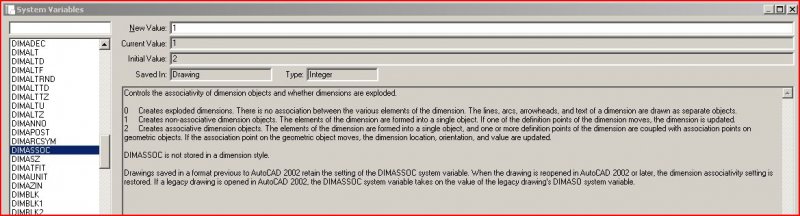

MSasu Posted April 22, 2014 Share Posted April 22, 2014 This behavior is controled by DIMASSOC system variable which is set to 0 in that trouble-maker drawing; adjust it to 2. Quote Link to comment Share on other sites More sharing options...

WindowsIHateYou Posted April 22, 2014 Author Share Posted April 22, 2014 Thanks. I've actually never used that variable before, or even heard of it. Problem solved. =) Quote Link to comment Share on other sites More sharing options...
