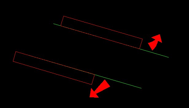

Grrr Posted April 25, 2014 Author Share Posted April 25, 2014 (edited) Hi Stefan BMR, I was skeptic at first while trying the lisp, but then I re-read your post. Indeed it works perfectly with polyline segments, and not that good with lines. It seems that it matters which side of the "segment" or the line is picked as destination and source. Please check the following dwg where you can see the results of the different situations http://www.sendspace.com/file/j9vrq0 Theres no worries for the "complicated object" being a block, because in Step1 selected objects can be anything from the model, but the objects that must be aligned (which I call source and destination line) can appear in form of a lines/single segment polylines/segment of a multi-segment polyline (they are selected in Step2 and Step3). Yes, there's a chance that it could be selected a line from a block (for a destination or source line) but thats a question for developing the lisp, now I just want to focus on the main task. Theres already lisp for aligning with blocks http://www.cadtutor.net/forum/showthread.php?47495-Align-Block-to-Curve but nothing I could find for a line/pline or other objects. If you could adapt it to work with lines also it would be enough for me EDIT: ReMark: Rotating the UCS is not a good option for editing many objects with different rotation (You must rotate the UCS each time for performing edit) and its not comfortable, especially if you have heavy drawing - instead of quick align, edit, and re-align objects process. Also as lamensterms stated if the road moves - the task is nearly impossible. eldon: Time is everything, I also used rotate with reference - but if there was easier and faster method, people would never thought about the normal aligning method or rotating with reference. If it was Autodesk's built in, they would ask you "Why you don't just use align with picking lines?" Edited April 25, 2014 by Grrr Quote Link to comment Share on other sites More sharing options...

highflybird Posted April 25, 2014 Share Posted April 25, 2014 Interesting code. I just test it, find two cases occurred.Can't choose the direction? Quote Link to comment Share on other sites More sharing options...

noeljarod Posted September 23, 2022 Share Posted September 23, 2022 On 4/25/2014 at 6:19 AM, highflybird said: Interesting code. I just test it, find two cases occurred.Can't choose the direction? Same question here, I dont know anything about lisp programming, please give me some help. Quote Link to comment Share on other sites More sharing options...
