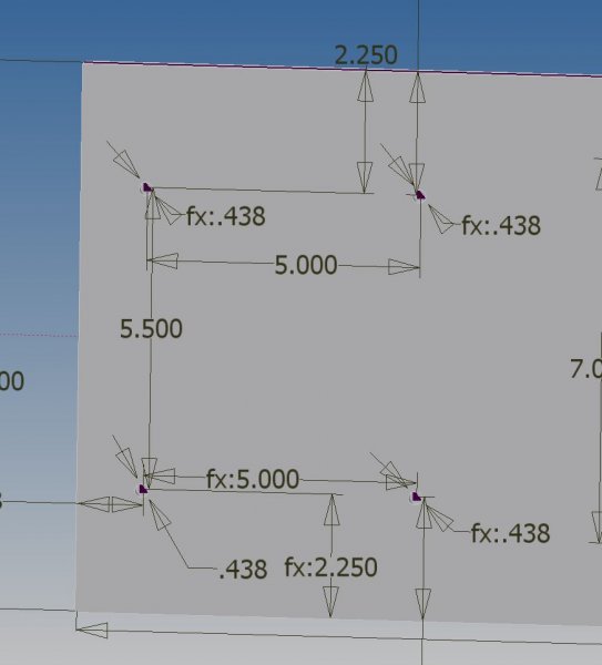

(well, except for the fact that you have wayyyyy more dimensions than needed to define that simple sketch. Attach the *.ipt file here if you want to learn how to do it right)

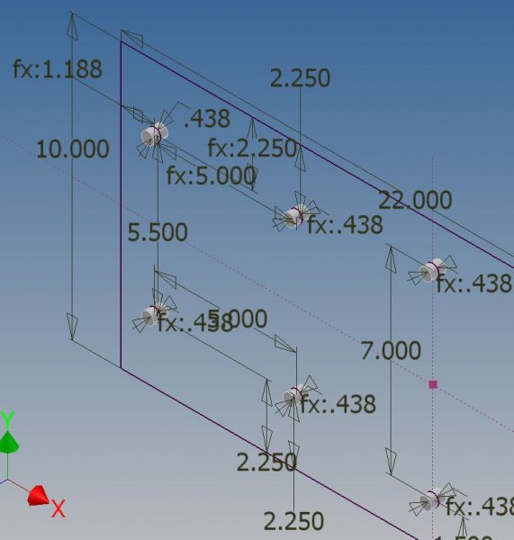

Sorry, i misunderstood, i thought you wanted me to Re share my sketh on this thread, anyway, i saw some holes but they didn't cut through, i used extrude--Cut and on Extents "To". I was not able to use the hole command. what did i do wrong?

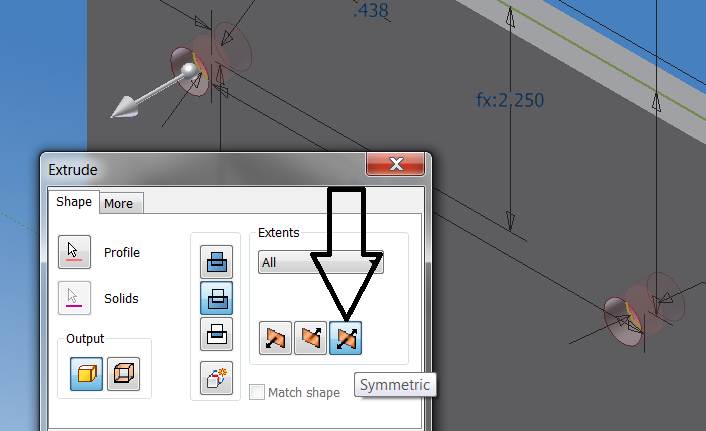

You would to an Extrude - Cut midplane (symmetrical) through All for the circles.
The better way would have been to use sketch centerpoints and the Hole command.
I don't understand why the hole didn't go through even though I cut through all.
Hole? Or Extrude? (two different feature types)
If Extrude, your circle is in the middle of the part.
You must tell Inventor to cut in both directions (symmetric or midplane).

Is there a way that i can temporary turn off those dims while i am extruding or editing obj so that i can see those holes?
Right click on the sketch in the browser and uncheck Dimension Visibility.
Extrude cut.jpgWhat happened, after extruded the holes, but the plate didn't show the thickness? i did turn on the visibility.
Think of the hole command as just that, a command to drill a hole. It creates the feature the same way you would actually have to drill, counterbore, countersink, and tap a hole. In other words you can only drill in one direction. The hole feature begins at a location (your sketch plane) and drills/bores to a specified depth or through the material in one direction. It does not include the symmetric or asymmetric directions. Your sketch is in the middle of the part, so the hole command starts there and goes in only one direction (You couldn't actually drill a counterbore in the middle of a part , could you? So the command doesn't allow that either). (Well maybe you could EDM a counterbore:)!) To cut all the way through this part, use the extrude command with the symmetric option. Reasons to use the hole command over extrude is you can add threads, counterbores, etc... in one feature. And if you detail the part in a drawing the Hole and Thread callout command will list and identify all the other counterbore and thread features on that hole. if you want to use the hole feature, move your sketch plane to the surface you want to start drilling from.
