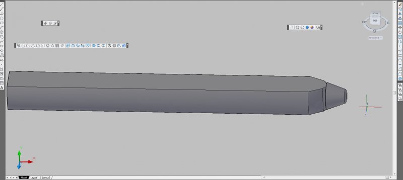

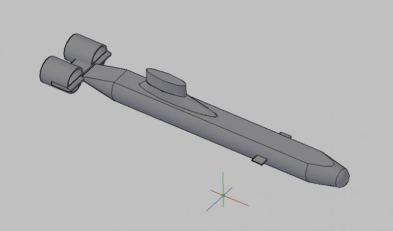

levimfa Posted April 21, 2014 Author Posted April 21, 2014 I achieved to make the submarine's body. I used the loft>guides command to obtain the chamfered effect on the top and in the bottom. But now I'm having problems with the submarine's nose. How to unite it to the the body? Any idea? Quote

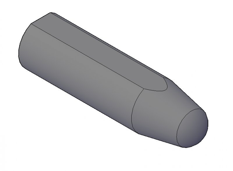

ReMark Posted April 21, 2014 Posted April 21, 2014 Isn't this more like what you are trying to achieve? Quote

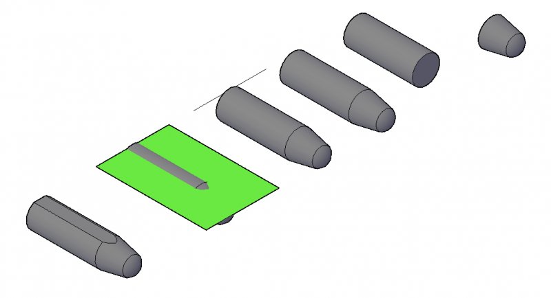

ReMark Posted April 21, 2014 Posted April 21, 2014 This is how I achieved the end result pictured in my previous post from the nose at the far right to the nose/body with bevel on the far left. The nose was just a revolved profile. Quote
levimfa Posted April 22, 2014 Author Posted April 22, 2014 ReMark said: [ATTACH=CONFIG]48250[/ATTACH]This is how I achieved the end result pictured in my previous post from the nose at the far right to the nose/body with bevel on the far left. The nose was just a revolved profile. Sorry for keep you waiting for a long time. As I mentioned on this post, I am a beginner. I am learning while I'm reading this. So, Can you explain me where I have to go to obtain the step where the green plan appears? How can I do it? Thank you very much for your support. Quote
ReMark Posted April 22, 2014 Posted April 22, 2014 That "plane" is just a line that has been extruded and used as the cutting "surface" in the SLICE command. Quote

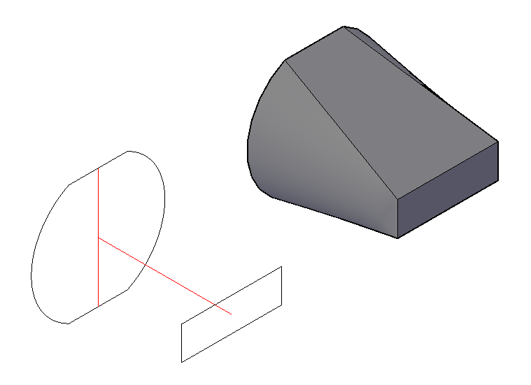

ReMark Posted April 23, 2014 Posted April 23, 2014 (edited) Once again this is only for demonstration purposes only as I have no idea what any of the dimensions are. How are you coming up with the dimensions you are using? To the left are the two polyline profiles I started with. The red lines are just part of my construction geometry (ignore them). To the right is the result I got by using the Loft command. The bottom of the object has the same taper as the top. By the way, are you sure you have the right design for the Typhoon-class submarine? Wasn't that a Russian submarine? Edited April 23, 2014 by ReMark Quote

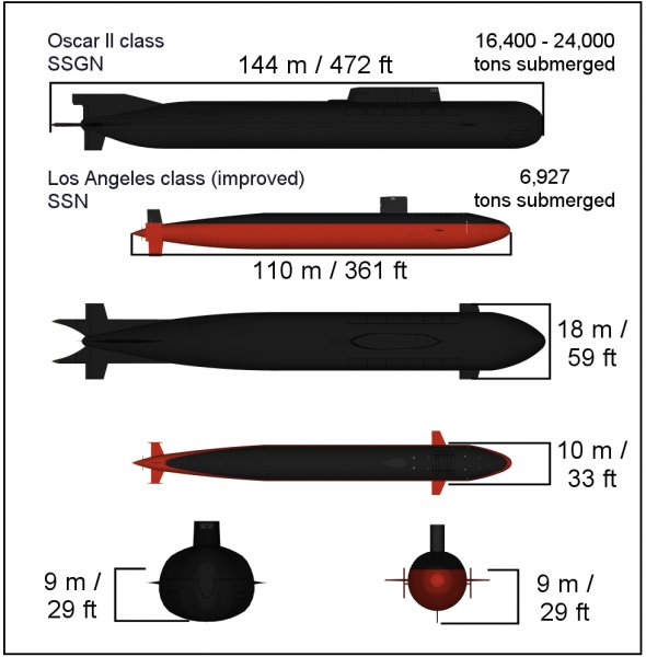

levimfa Posted April 25, 2014 Author Posted April 25, 2014 ReMark said: Have you made any further progress? Hey Remark! I had to stop the work for the exams. I plan back to it tomorrow, and I will post my steps here. Answering your last questions...the dimensions haven't been clearly defined yet. I am searching for projects in internet to get real references (Haven't you got something like this to help me?). So I used what I could find by now. Like this picture: About the Typhoon name..well, I obtained this picture on the internet to train my modeling skills, and in the description, it was called of Typhoon submarine. But I don't have preferences for the class, I just chose start with a easy model. I'll try other types of vessels too. Quote
ReMark Posted April 25, 2014 Posted April 25, 2014 The trouble with the submarine is the fact you do not have a fully dimensioned diagram to work off it. All you have are a handful of overall dimensions so the end result may not look correct. Since you are new to 3D I would have suggested starting off with some basic 3D models and as your skills increased transition to more complex models. That's how it is normally done in a structured class. Quote

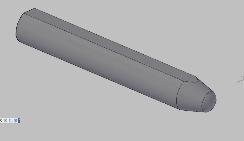

levimfa Posted June 20, 2014 Author Posted June 20, 2014 A little bit different, but finally is finished. In fact, almost finished, missing only the propellers. Quote
