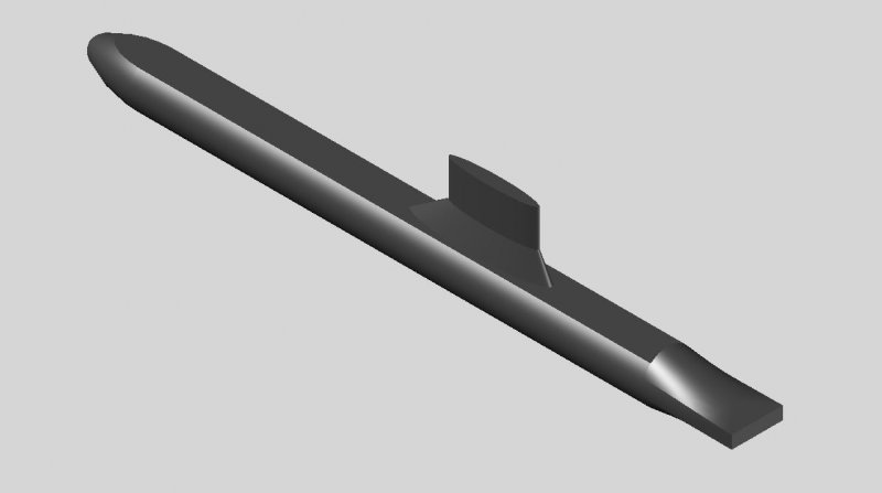

ReMark Posted April 18, 2014 Posted April 18, 2014 Different parts of the sub may require different techniques. Quote
ReMark Posted April 18, 2014 Posted April 18, 2014 Disclaimer: This is NOT your sub. It is a sub-like object created in sections (nose, main body, tail, and topside). It is also incomplete. The point being that each section required a different approach. Quote

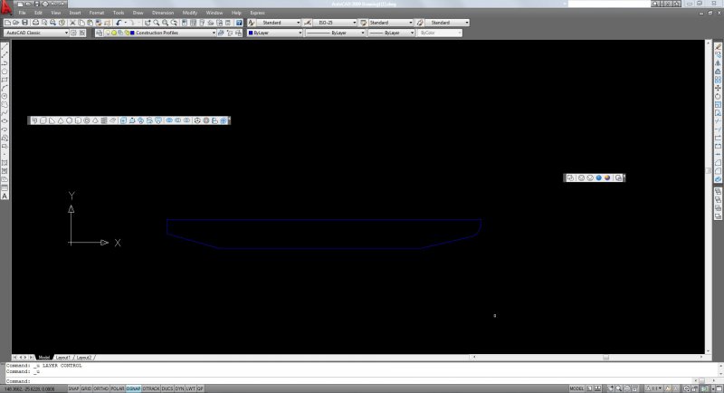

JD Mather Posted April 18, 2014 Posted April 18, 2014 levimfa said: Here it is. I did the way I did before. I drew just one side of the outline, and the line in the center is the axis for the revolve command. Do you know how to create layers? Create a layer named Construction Profiles. Create a layer named Construction Surfaces. Create a layer named Solid. Use the Polyline Edit command (PE Enter) with the Joint (J) option to join the polyline you have to the axis line you have. The goal is a closed profile. Move the profile to the Construction Profiles layer. Attach the file here. Quote
levimfa Posted April 19, 2014 Author Posted April 19, 2014 (edited) JD Mather said: Do you know how to create layers?Create a layer named Construction Profiles. Create a layer named Construction Surfaces. Create a layer named Solid. Use the Polyline Edit command (PE Enter) with the Joint (J) option to join the polyline you have to the axis line you have. The goal is a closed profile. Move the profile to the Construction Profiles layer. Attach the file here. Here it is, JD Mather: Edited April 23, 2014 by levimfa Quote

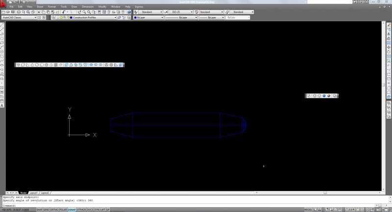

JD Mather Posted April 19, 2014 Posted April 19, 2014 Revolve the profile and move the solid body to the Solid layer. Do not delete the profile (unless you like creating the same geometry over and over again). Quote

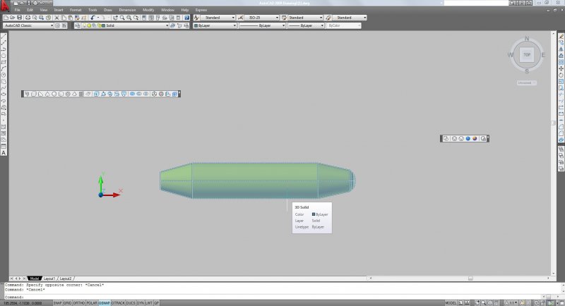

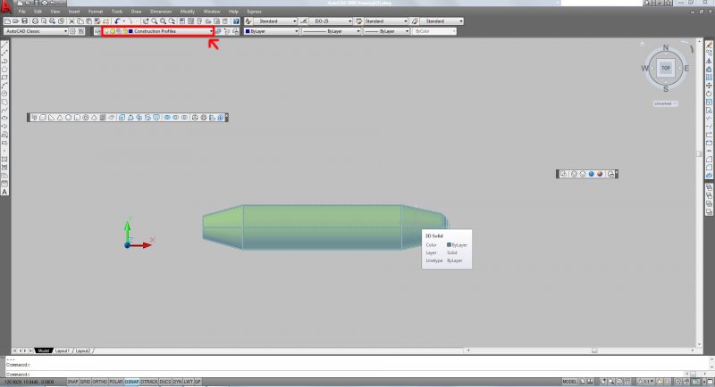

levimfa Posted April 19, 2014 Author Posted April 19, 2014 (edited) JD Mather said: Revolve the profile and move the solid body to the Solid layer.Do not delete the profile (unless you like creating the same geometry over and over again). Right. Done! Now I have returned to the solid that I had. From here I don't know how to proceed to get the chamfered effect and the decline on the back. Edited April 23, 2014 by levimfa Quote
JD Mather Posted April 19, 2014 Posted April 19, 2014 levimfa said: Right. Done! Now I have returned to the solid that I had. From here I don't know how to proceed to get the chamfered effect and the decline on the back. If you had a solid before - why did you post the surface model here instead of the solid model? My guess is that you don't know what you had before. What happened to the construction profile? I don't see anything on your construction profile layer? You have delobj set to 0 (off) so your original profile used for the revolved solid should still be there? What happened to it? You didn't delete it did you? I'm I missing something here? I don't see the profile? Quote

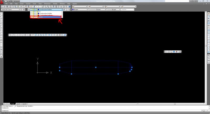

levimfa Posted April 19, 2014 Author Posted April 19, 2014 (edited) JD Mather said: If you had a solid before - why did you post the surface model here instead of the solid model?My guess is that you don't know what you had before. What happened to the construction profile? I don't see anything on your construction profile layer? You have delobj set to 0 (off) so your original profile used for the revolved solid should still be there? What happened to it? You didn't delete it did you? I'm I missing something here? I don't see the profile? After the revolve, I moved the solid body obtained to the solid layer as you requested. This is why the original profile is not visible. --------- I still do not dominate the AutoCAD very well, I'm learning it. This is the reason of my apparent difficulty. Edited April 21, 2014 by levimfa Quote
JD Mather Posted April 19, 2014 Posted April 19, 2014 If you type the variable name delobj and hit Enter - what does your command line say it is currently set to? Quote
levimfa Posted April 19, 2014 Author Posted April 19, 2014 JD Mather said: If you type the variable name delobj and hit Enter - what does your command line say it is currently set to? DELOBJ I have to type 0 before the revolve? Quote
JD Mather Posted April 19, 2014 Posted April 19, 2014 Ah, that explains it. I thought that setting was stored in the file. I have it set on 0 (off) on my machine so that construction geometry is preserved. Quote
