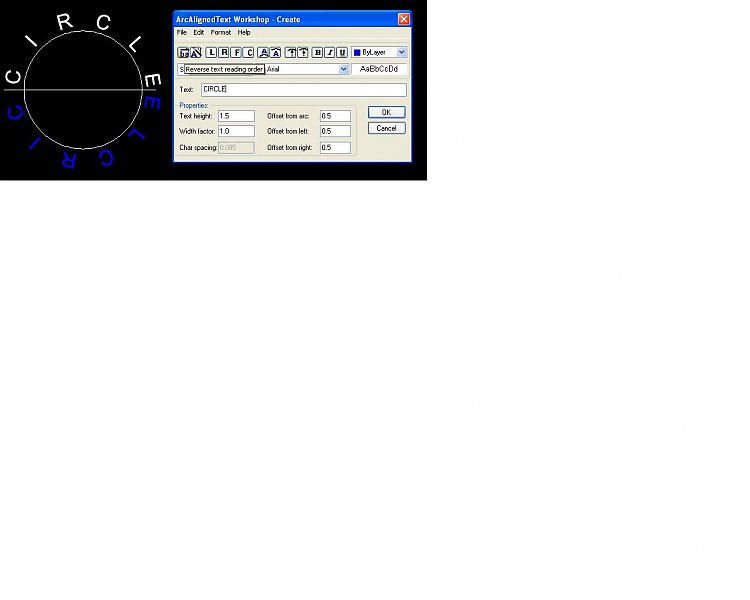

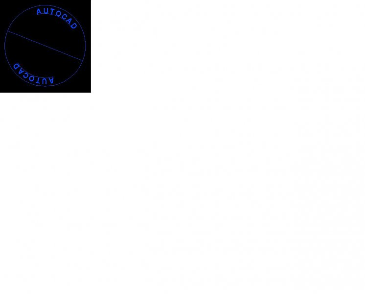

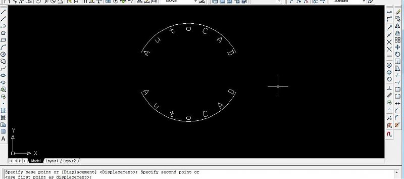

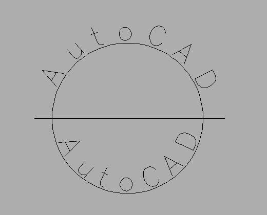

fly Posted November 21, 2008 Posted November 21, 2008 arctext is working perfectly, but text start from the left to the right (clockwise) ...... in the upper side of the circle is ok, but in the lower side....is upside down! any suggestions? Quote
Strix Posted November 21, 2008 Posted November 21, 2008 set the text to be upside down before you start typing? Quote
fly Posted November 21, 2008 Posted November 21, 2008 nope, doesn't work...in the lower side text will be upside down ... the only option i have with arctext is "reverse text reading order". Quote
eldon Posted November 21, 2008 Posted November 21, 2008 Play around with all the settings and you will get it. It is possible. Quote
soleary Posted November 21, 2008 Posted November 21, 2008 eldon said: Play around with all the settings and you will get it. It is possible. Haha Eldon. Learn by doing right? I agree, it's the best way!! :wink: And you are right, it is possible Quote
