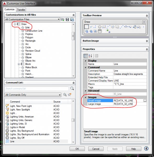

Newbie here. Please forgive me if this topic has been asked before. I just recently installed AutoCad2012 LT and loaded my old menu (tools) from an older version AutoCad and was able to load it and able to make everything work on AutoCad2012 LT except now I have all this icons with cloud and a ? on them? How can I restore my icons back? Any advice will be greatly appreciated.
What "older" version of AutoCAD are we talking about?
It could be that the internal icon name has changed and instead of being referred to as "ICON" it is now referred to as "RCDATA".

It was working on my AutoCad 2005. So should I change "ICON" to "RCDATA"?

Check also CONFIG, FILES, Customization Files, Custom Icon Location
All my icons (RCDATA) points to the correct path. It is so frustrating. So near and yet so far. I know it's there, but yet it's not there!!! LOL.
And thank you so much for all of your replys ReMark and BIGAL really appreciate it. Somehow I know we will find a solution for this.

What do you see when you open the CUI where it says Images? Refer to the pic below.
The example I posted was for a partial toolbar menu not using CUI edit.
[ATTACH=CONFIG]49197[/ATTACH]
This what I have. Do I just simply delete "ICON" and replace with "RCDATA"?
