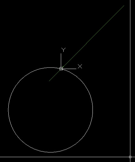

Here's the initial situation:

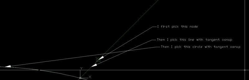

Then I do:

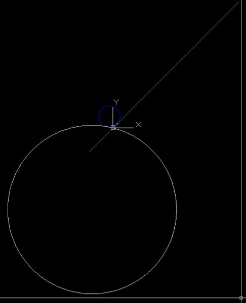

And the result is:

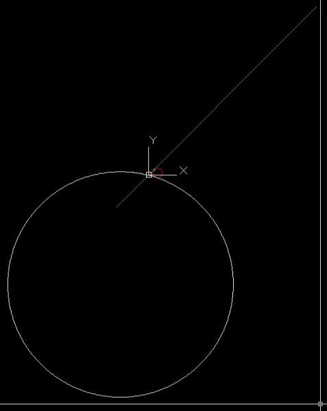

The intended result would be something like this (done manually and with no precision):
As you can see, AutoCAD is drawing the circle on the wrong side. No matter where I try to click to pick the tangents, the result is always the same.

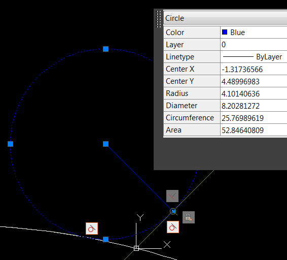

It has, indeed. I saw your replies on other threads with similar subjects but I couldn't find any good tutorial on how to use constrains. I was interested though.
Could you point me some material for a beginner on the subject?
