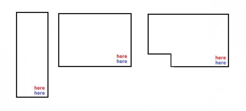

simbamat Posted April 17, 2014 Author Share Posted April 17, 2014 Thanks! Thanks! Thanks! How can I change the font color? How to change the position of text? Quote Link to comment Share on other sites More sharing options...
Costinbos77 Posted April 18, 2014 Share Posted April 18, 2014 (edited) 1 . This creates layers ; Find it : (vl-cmdF "_.Layer" "n" "Area,Perimeter" "c" [color="red"]1[/color] "Area" "c" [color="blue"]5[/color] "Perimeter" "") 1 = red ; 5 = blue ; Put what colors you like. 2 . How to change the position of text? Surface texts are inserted in the middle? Where do you put them? Attach a DWG example. Or mode tag = justify ( middle left, center, middle , bottom right ) ? Edited April 18, 2014 by Costinbos77 Quote Link to comment Share on other sites More sharing options...
simbamat Posted April 18, 2014 Author Share Posted April 18, 2014 Example in "Paint": Quote Link to comment Share on other sites More sharing options...

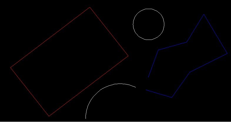

Costinbos77 Posted April 18, 2014 Share Posted April 18, 2014 It is possible, but more complicated. How do with circles or arcs of a circle? If the rectangle is tilted, rotated or irregular ? Quote Link to comment Share on other sites More sharing options...

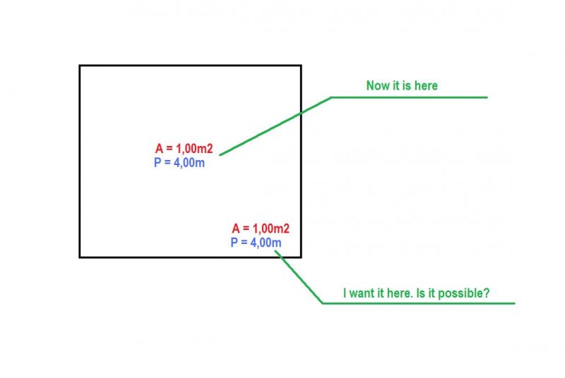

simbamat Posted April 19, 2014 Author Share Posted April 19, 2014 You have right. It is complicated. But I usualy use object like this: Its possible to make second version of the LISP for me? Thanks! Quote Link to comment Share on other sites More sharing options...
Costinbos77 Posted April 19, 2014 Share Posted April 19, 2014 (edited) If you insist, look: (defun C:AreaPer ( / ar coHt coDec coTP eN hT2 i lStrA lStrP lTa p pr pMin pMax osm sel sL strA strP tD ti tO uL ) ; dec hT (princ "\n C:AreaPer : V : 17 . 04 . 2014 ;") (or (vl-Load-Com)) (setVar "CmdEcho" 0) (setVar "OrthoMode" 0) (princ "\n Select Objects : [ Arc, Circle, LwPolyline, PolyLine, ] ;") (if (setq sel (ssGet '((0 . "Arc,Circle,LwPolyline,PolyLine,SplineX")) ) ) (progn (if (not (numberP hT)) (setq hT 1.)) ; Real (if (not (numberP dec)) (setq dec 3)) ; Integer (setq coHt (getString (strcat "\n Font Height : < Enter = " (RtoS hT 2 3) " > : ")) coDec (getString (strcat "\n Precission : < Enter = " (ItoA dec) " > : ")) coTP (getString (strcat "\n Text Position : Any = Center ; < Enter = Right > : ")) osm (getVar "osMode") uL (getVar "insUnits") strA "Area" lStrA (cons 8 strA) strP "Perimeter" lStrP (cons 8 strP) i -1) (if (/= coHt "") (setq hT (AtoF coHt)) ) (if (/= coDec "") (setq dec (fix (AtoF coDec))) ) ; 0 = Unspecified (No units) , 1=Inches , 4=mm , 5= cm ; 6=m ; 7=km. (setq ti (car (_VL-Times)) hT2 (* hT 2.) ) ;_ end of setq (cond ((= uL 0) (setq sL 1.00 tO "Unitless")) ((= uL 1) (setq sL 2.54e-2 tO "Inch")) ((= uL 2) (setq sL 0.3048 tO "Feet")) ((= uL 3) (setq sL 1609.344 tO "Miles")) ((= uL 4) (setq sL 1e-3 tO "mm")) ((= uL 5) (setq sL 1e-2 tO "cm")) ((= uL 6) (setq sL 1.00 tO "m")) ((= uL 7) (setq sL 1e+3 tO "Km")) (T (setq sL 1.00 tO "Any")) ) ;_ end of c (alert (strCat "DWG Length Units is :\n\n " (ItoA uL) " = " tO " ;\n\n Factor = " (RtoS sL 2 9) " !")) (setVar "osMode" 0) (vl-cmdF "_.Layer" "n" "Area,Perimeter" "c" 1 "Area" "c" 5 "Perimeter" "") (command "_.Style" "Arial" "Arial" "0" "1" "0" "N" "N") ;_ end of c (acet-ui-Progress "Processing : " (ssLength sel)) (repeat (ssLength sel) (setq i (1+ i) eN (vlax-eName->Vla-Object (ssName sel i)) ) (if (vlax-Property-Available-P eN "Area") (progn (setq ar (* (vla-Get-Area eN) sL sL) tip (substr (vla-Get-ObjectName eN) 5) pr (* (cond ((vlax-Property-Available-P eN "Length") (vla-Get-Length eN)) ((vlax-Property-Available-P eN "Circumference") (vla-Get-Circumference eN)) ((vlax-Property-Available-P eN "ArcLength") (vla-Get-ArcLength eN)) ;;; ((vlax-Property-Available-P eN "Perimeter") (vla-Get-Perimeter eN)) (T 0) ) sL) ) ; (prinC (strCat "\n " (ItoA i) " : " tip " : Area = " (RtoS ar 2 dec) " m² ; Perimeter = " (RtoS pr 2 dec) " m ;")) (vla-GetBoundingBox eN 'pMin 'pMax) (setq pMin (vlax-SafeArray->List pMin) pMax (vlax-SafeArray->List pMax) lTa (cons 1 (strcat "A = " (RtoS ar 2 dec) " m²")) ) (if (= coTP "") (setq tD (textBox (list lTa (cons 40 hT) '(50 . 0) '(7 . "Arial")) ) ; (caar td) p (list (- (car pMax) (caadr td)) (+ (cadr pMin) hT2)) ) (setq p (mapcar '/ (mapcar '+ pMin pMax) '(2. 2. 2.)) ) ) ; if (entMake (list '(0 . "Text") (cons 40 hT) '(50 . 0) lStrA '(7 . "Arial") '(72 . 4) '(10 0 0 0) lTa (cons 11 (mapcar '+ p (list 0 hT2 0))) ) ) (entMake (list '(0 . "Text") (cons 40 hT) '(50 . 0) lStrp '(7 . "Arial") '(72 . 4) '(10 0 0 0) (cons 1 (strcat "P = " (RtoS pr 2 dec) " m")) (cons 11 p) ) ) )) ; if (acet-ui-Progress -1) ) ; r (acet-ui-Progress) (setVar "osMode" osm) )) ; if ;;; (setVar "cLayer" "0") (princ (strCat "\n Objects : " (ItoA i) " ; Time : " (RtoS (/ (- (car (_VL-Times)) ti) 1000.) 2 2) " s ;")) (princ "\n C:AreaPer : END ;") (setVar "CmdEcho" 1) (princ) ) From what I've seen, you do not know AutoLisp. It would be good and you learn this programming language, is easy and very useful. While working with AutoCAD, you always need programs to help you work. PS : Today I leave on vacation in the country for at least one week and I don't have internet there. So we hear after Easter vacation . Edited April 19, 2014 by Costinbos77 Quote Link to comment Share on other sites More sharing options...
