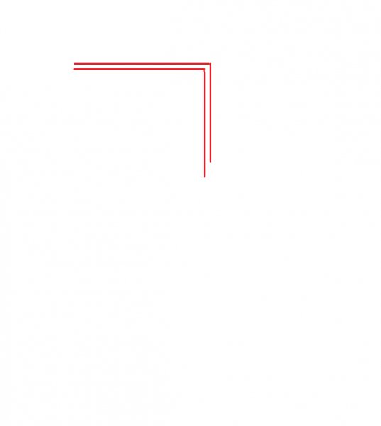

Hi, I am trying to make a makro or custom command to draw two polylines of varying lengths using a mouse 60mm apart snapped to two entities then when finished have one line 60mm shorter than the other. This is to connect a number of pipes in a plumbing drawing, cheers and any help would be greatly appreciated.
Since you are using LT, I'm afraid you cannot use custom commands (AutoLISP, ARX or .Net); the script technology is available, but unfortunately there is no user input allowed during their execution. However in order to allow someone to suggest a solution based on a script, please post a sketch of what you are trying to achieve.

I have attached a rough sketch of what I am trying to do.
If I could draw two lines 60mm apart on a selected layer which would give the linestyle and colour, these lines would be of varying lengths and change direction the when terminated one to be 60mm shorter than the other.
Any help would be greatly appreciated, best regards
How would you determine which line is to be shorter, but another question, have you seen the command "dline" it will draw a double line at the width you tell it, but it means picking points on the centre line.
Hi Stephen, thank you for your reply, I have tried dline and whilst it is a step in the right direction both lines are the same length and have to be trimmed to 60mm difference.
It doesn't really matter which line is shorter as long as one is which gives the connection to the pipe, cheers
I'm prety sure that you cannot automate that task with a macro. This is due to the fact that LT don't allows you to add required "inteligence" and also macro technology don't permit user interaction. Sorry!
Maybe simplest manual method if they are always ortho draw the two lines make sure ortho on F8, F3 no osnap, click line end grip, move up using mouse type 60 it will shorten line exactly 60.

I would do a STRETCH on one part (picking from/to points on one of lines) to exceed intersection point and next step will do required EXTEND / TRIM operations (using to toggle between actions).
This should cover any orientation and/or relative angle between parts.
