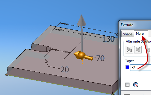

JD Mather Posted April 25, 2014 Author Share Posted April 25, 2014 Extrude the sketch a distance of 30mm with a Taper of -7°. Quote Link to comment Share on other sites More sharing options...

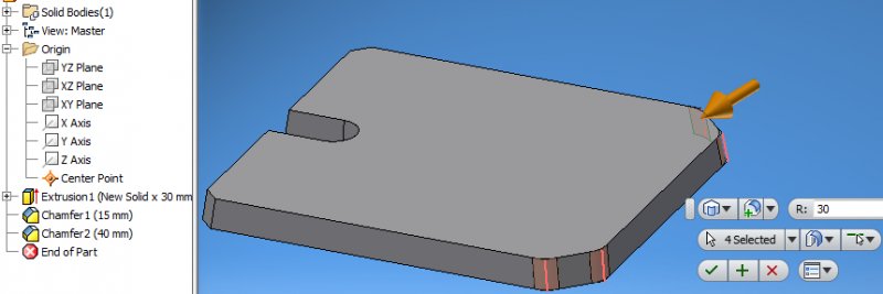

JD Mather Posted April 25, 2014 Author Share Posted April 25, 2014 Add 15mm Chamfers to the two outside vertical edges on the left side and 40mm Chamfers to the two vertical edges on the right side. Quote Link to comment Share on other sites More sharing options...
JD Mather Posted April 25, 2014 Author Share Posted April 25, 2014 Add 30mm Fillets to the vertical edges of the two 40mm Chamfers. Quote Link to comment Share on other sites More sharing options...

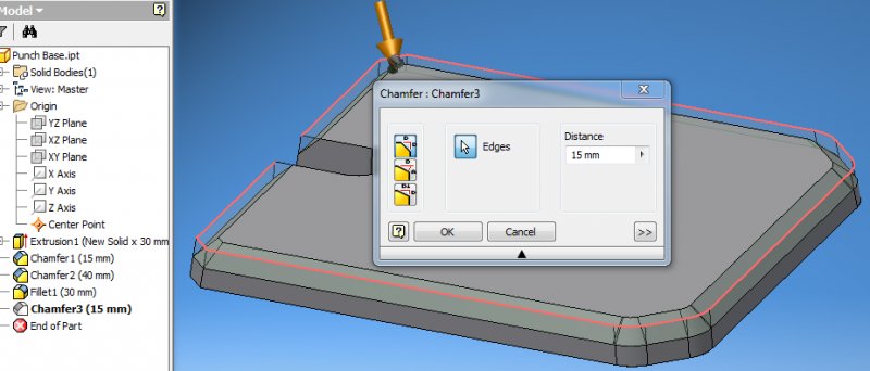

JD Mather Posted April 25, 2014 Author Share Posted April 25, 2014 Add a 15mm Chamfer all the way around the top outside edges (be sure to click the top of the previous 15mm Chamfers). Quote Link to comment Share on other sites More sharing options...

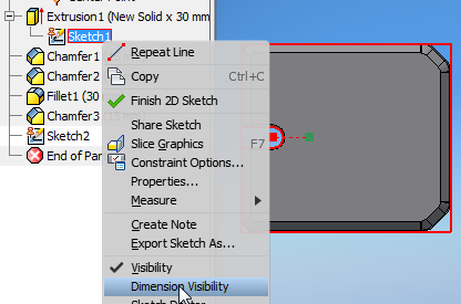

JD Mather Posted April 25, 2014 Author Share Posted April 25, 2014 Expand Extrusion1 and turn on the Visibility of Sketch1. Right click on Sketch1 and uncheck the Dimension Visibility. Start a New Sketch on the top face of the part. Quote Link to comment Share on other sites More sharing options...

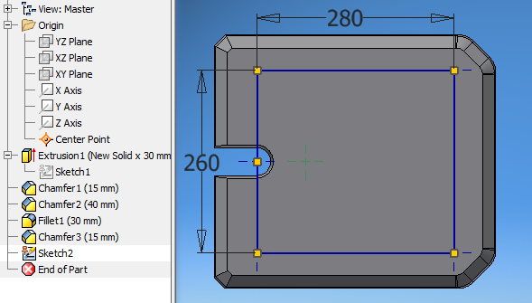

JD Mather Posted April 25, 2014 Author Share Posted April 25, 2014 Project Geometry the centerpoint of the arc from Sketch1 as shown into Sketch2. Sketch the Rectangle shown. Quote Link to comment Share on other sites More sharing options...
JD Mather Posted April 25, 2014 Author Share Posted April 25, 2014 Add a Coincident Constraint between the projected center point and the midpoint of the left vertical line of the rectangle. Quote Link to comment Share on other sites More sharing options...

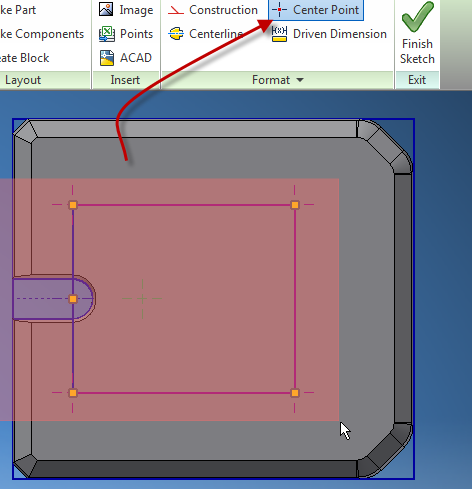

JD Mather Posted April 25, 2014 Author Share Posted April 25, 2014 Window select the rectangle and toggle the line endpoints to Center Points. Right click on Sketch1 and turn off the Visibility of Sketch1. Finish Sketch2 and save the file. Quote Link to comment Share on other sites More sharing options...
JD Mather Posted April 25, 2014 Author Share Posted April 25, 2014 Dimension the rectangle as shown. We have two extra Center Points (at the midpoint of the left vertical line and at the projected origin) that we don't really need and could toggle to Points, but there is no real need to do this. Quote Link to comment Share on other sites More sharing options...

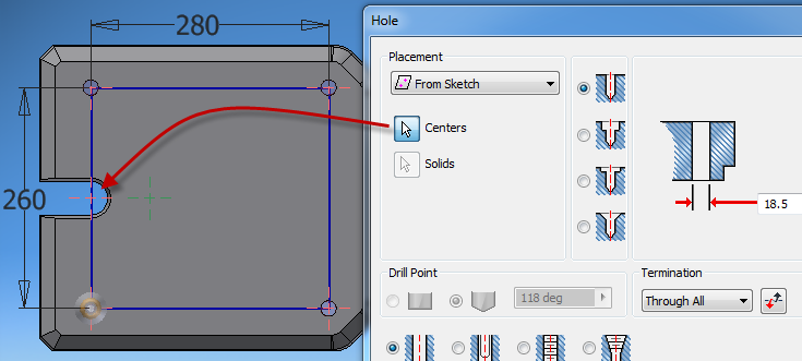

JD Mather Posted April 25, 2014 Author Share Posted April 25, 2014 Start the Hole command and hold the Ctrl key and unselect the two extra points as shown. Enter 18.5mm Through All as the parameters. (Tip: If you missed this step and accidentally created the two extra holes - you could always right click to edit the feature and then Ctrl unselect the two extra centerpoints.) Quote Link to comment Share on other sites More sharing options...

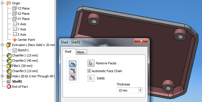

JD Mather Posted April 25, 2014 Author Share Posted April 25, 2014 Turn the part over so that you are looking at the bottom. Start the Shell command and click the bottom face of the part. Set the Thickness to 10mm. Quote Link to comment Share on other sites More sharing options...

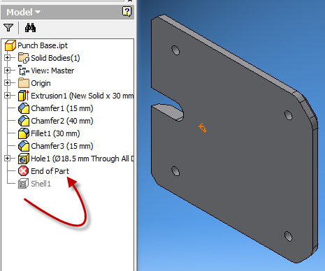

JD Mather Posted April 28, 2014 Author Share Posted April 28, 2014 Oops, I forgot a step. Delete the file and start over - right? NO! Well the step I "forgot" should have been done before the Shell feature. Delete the Shell feature - right? NO! Find the red End of Part marker (hereafter referred to as EOP) in the browser and drag it up above the Shell feature. Quote Link to comment Share on other sites More sharing options...

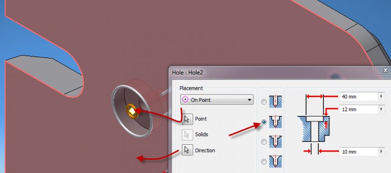

JD Mather Posted April 28, 2014 Author Share Posted April 28, 2014 Start the Hole command and this time use the On Point placement option. Click the Origin Center Point for the Point and the bottom face of the part to set the Direction. Click the Counterbored Hole option and set the parameters as shown. Drag the red EOP back down below the Shell feature. Quote Link to comment Share on other sites More sharing options...

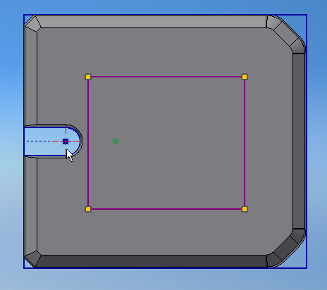

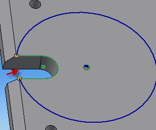

JD Mather Posted April 28, 2014 Author Share Posted April 28, 2014 Turn the part over and start a new sketch on the top face. Project Geometry the 4 edges as shown. Quote Link to comment Share on other sites More sharing options...

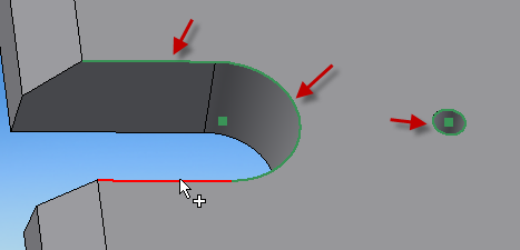

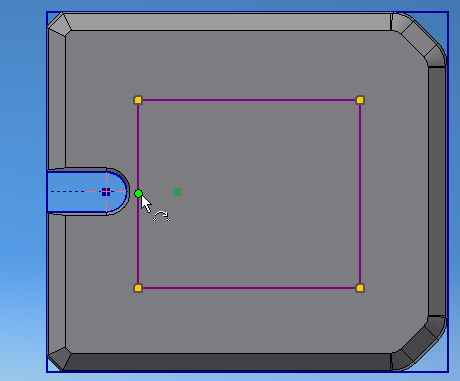

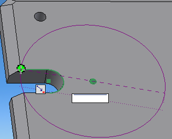

JD Mather Posted April 28, 2014 Author Share Posted April 28, 2014 Sketch a circle from the hole center to the green snap point as indicated. Quote Link to comment Share on other sites More sharing options...
JD Mather Posted April 28, 2014 Author Share Posted April 28, 2014 Trim the circle and then Extrude 8mm. Quote Link to comment Share on other sites More sharing options...

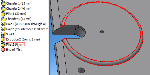

JD Mather Posted April 28, 2014 Author Share Posted April 28, 2014 Add an 8mm fillet around the top edge of the extruded cylindrical feature. Quote Link to comment Share on other sites More sharing options...
